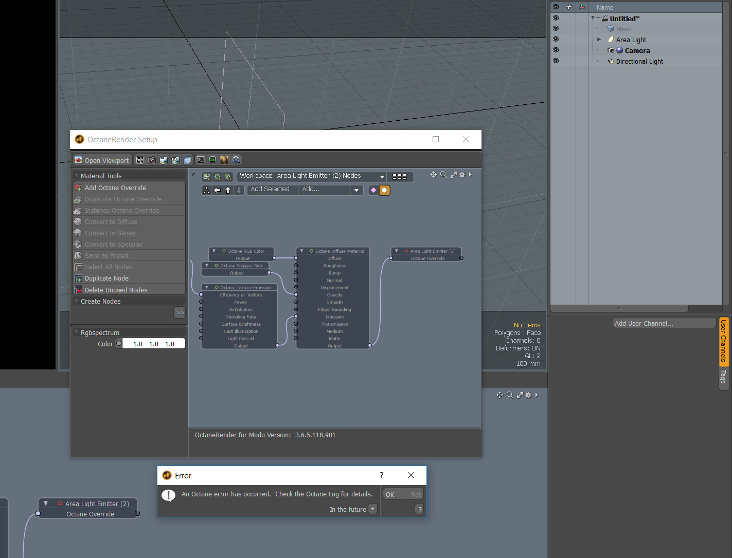

Hey Paul,
everytime i want to create an octane emitter from an arealight Modo crashes or an error occurs.
The log says:
Started logging on 18.05.17 14:53:19
OctaneRender 3.06 (3060005)
Tried to access null item
Tried to access attribute via invalid ID A_PIN_COUNT (113)
If there is no crash the octane emitter seems to work correctly
Greetings!
face_off
Posts: 15822
Location: Adelaide, Australia
This occurs if you create the emitter whilst the viewport is closed. This problem is fixed in the next release.
Paul
