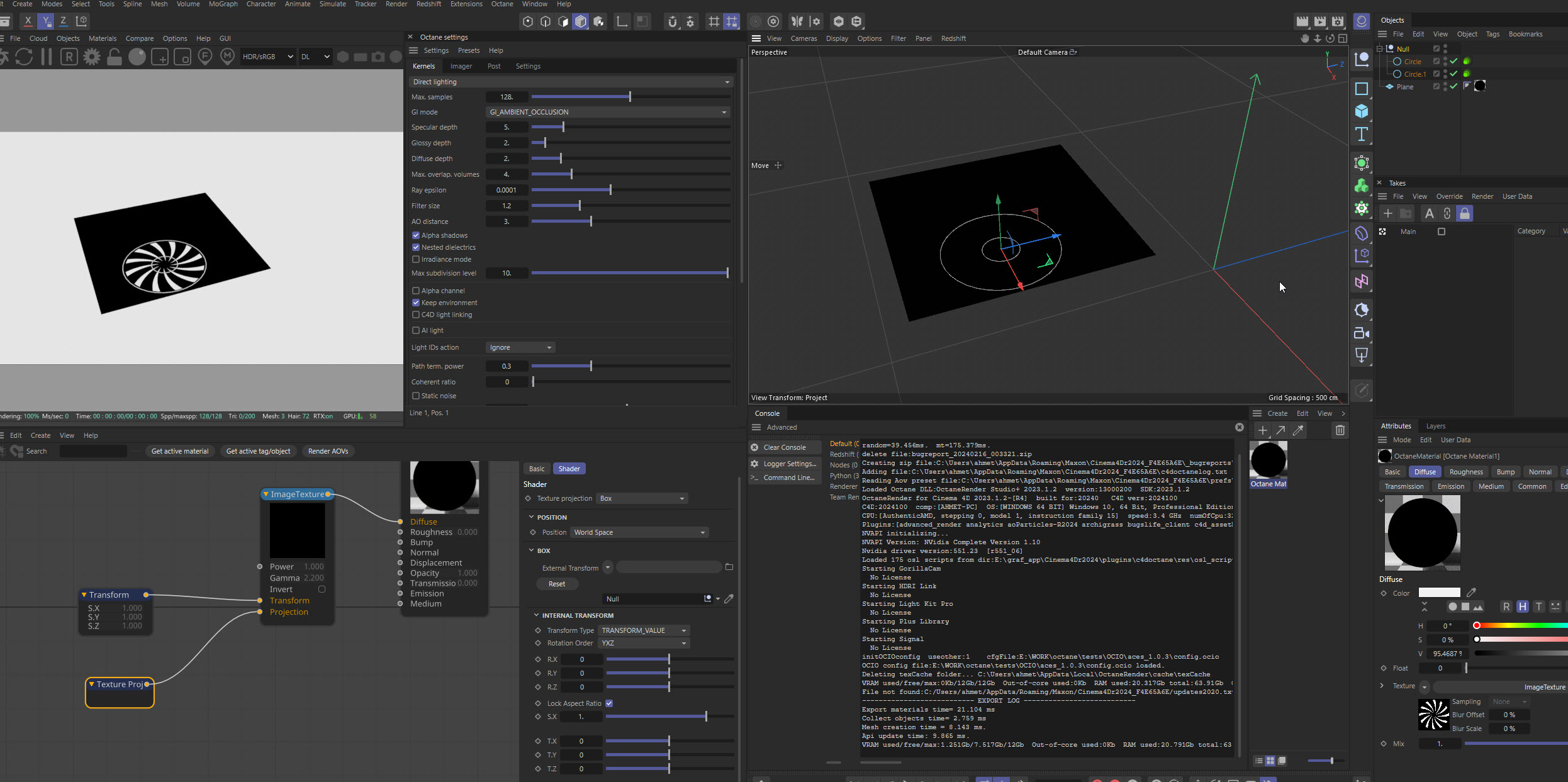

Disable/enable node group doesn't work.
Stacked materials completely doesn't update in LiveViewer
Reset button in Texture Projection doesn't work.
Transform - Link issue. It doesn't work with objects other than null but even using null it coordinates are wrong.
Generally it works fine but there is issue with T.Y input which works as T.Z input. It works different than in Projection node where T.Y move up - in Transform node T.Y move on Z axis. This is why it doesn't work well using Link. Please see transform_link_2.zip scene
T.Y and T.Z are inverted in Transform node compared to Projection node. Please fix.

Nothing wrong with that! It's just not a projection for coordinates, it's a transform matrix. And will not work as you think, just use projection node for correct positioning. But I can add an option to Transform node to switch coordinates.SSmolak wrote:
Also link in transform is working with objects, not sure why you say this!
It's not a thing I supposed to add.Disable/enable node group doesn't work.
I'll bring it back for Octane's native material. Disabled because a technical problem to avoid endless material refreshesStacked materials completely doesn't update in LiveViewer
It does a reset to values of transform. Nothing else!Reset button in Texture Projection doesn't work.
It would be great if you add this because link in Transform works only for X axis at the moment. Thank you !aoktar wrote:But I can add an option to Transform node to switch coordinates.
Yes I was wrong it works fine for objects. I tried axis Z which not work because of this problem.
