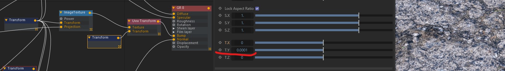

Please see this : viewtopic.php?f=24&t=80814&p=419382#p419382
Hard bug with Transform node connected to bump channel in UV Projection.
Solution :
bumpUV_bug_solution.zip
(4.11 MiB) Downloaded 218 times
Architectural Visualizations http://www.archviz-4d.studio

SSmolak wrote:Please see this : viewtopic.php?f=24&t=80814&p=419382#p419382
Solution :
It's not plugin related if it's really a problem. But not sure that's a bug or so. It may be due to nature of the nodes and maybe nothing to avoid it without your tricks. Sometimes math is hard to understand.

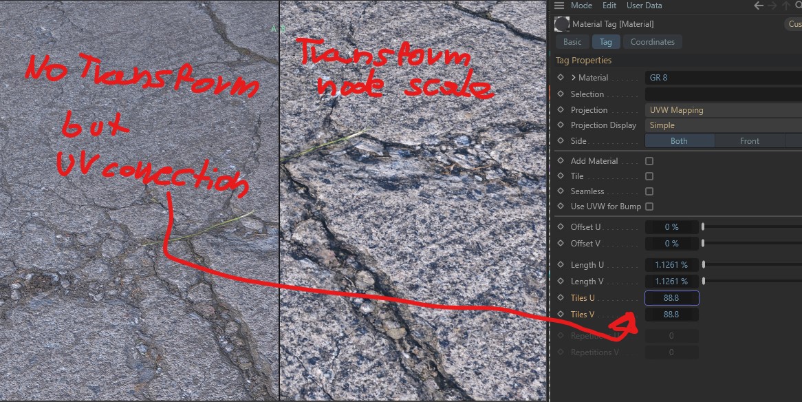

definitely something wrong because it looks fine with this :
But bump power is still to strong compared to box projection.
EDIT :
Bump power looks good if no transform node is used but scalling it by C4D :
