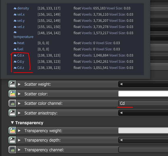

Does the standard volume medium support color(Cd) channel of the VDB to color the VDB using scatter color channel?
Imported a vdb having Cd channel from houdini, doesn't seem to be reading the channel in either standard volume medium node or volume to texture node
Edit - I merged all scalar Cd values to one Vector Cd value and still no color
Cd single.PNG (11.27 KiB) Viewed 3769 times

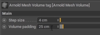

Another question, is it possible for mesh to fog node to have some sort of volume padding like in arnold?
mesh to volume.PNG (23.72 KiB) Viewed 3785 times

Meet wrote:Does the standard volume medium support color(Cd) channel of the VDB to color the VDB using scatter color channel?
The attachment vdb color.PNG is no longer available
The attachment Cd single.PNG is no longer available

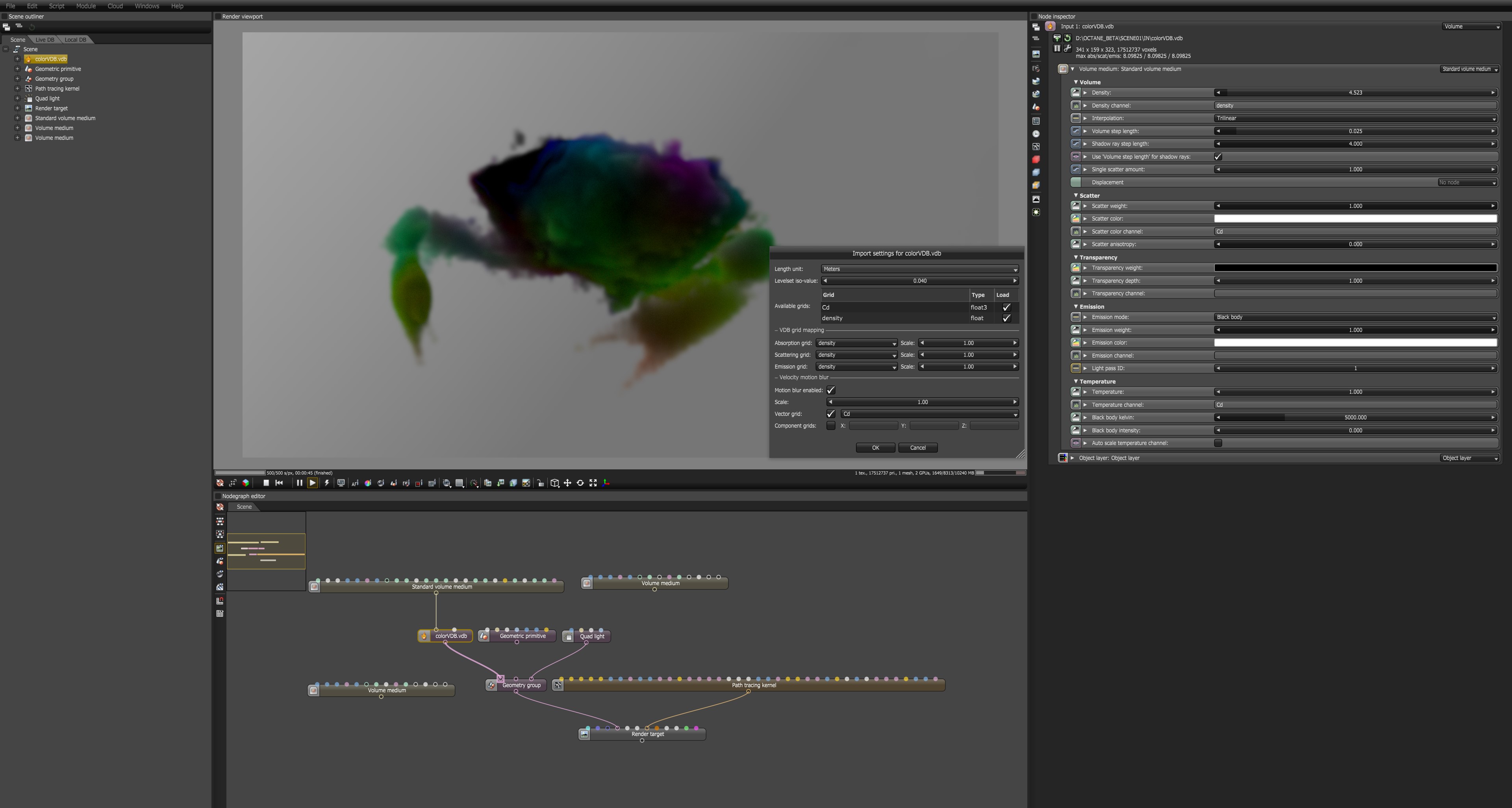

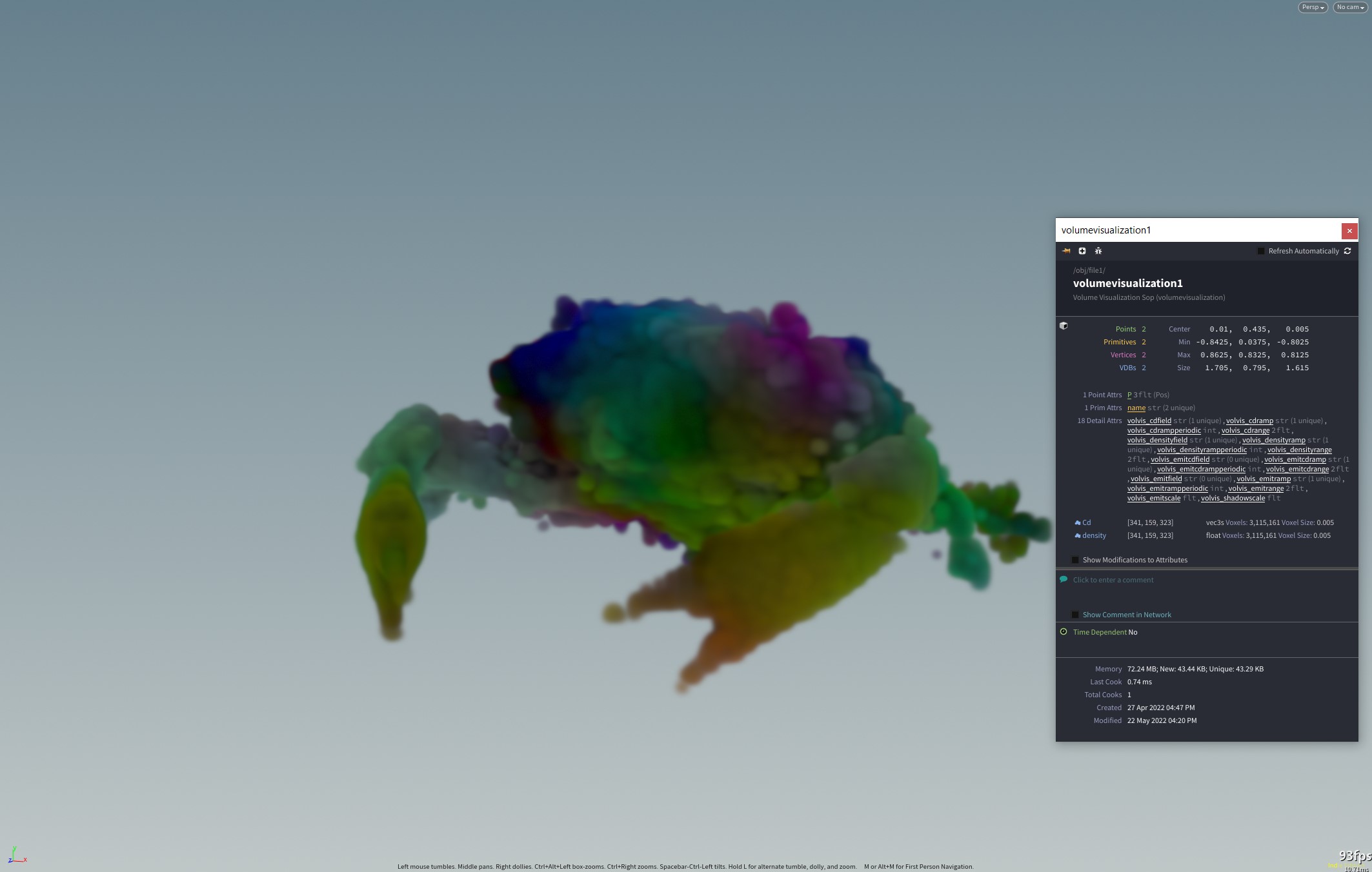

Yes, it does support it. I've attached the scene file for both Houdini and Standalone.
colorVDB.zip
(93.22 MiB) Downloaded 261 times

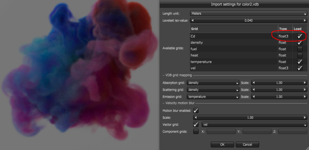

Thank you for the files, helped with troubleshooting.
I understood why it wasn't working, I had to toggle on the "Cd" option in the import settings
Seems to be working fine in standalone, doesn't work in C4d, maybe Aoktar can shed some light on that. I will post it in the C4D section.

Meet wrote:Another question, is it possible for mesh to fog node to have some sort of volume padding like in arnold?
Thank you for your suggestion, I think it makes sense and will add it to our list.
