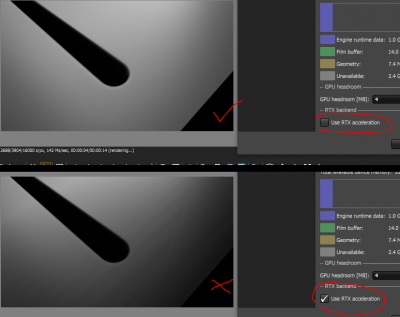

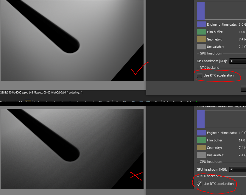

BUG: RTX On renders this wrong (EDIT: on a 3090)
The last scene I was working on in 2020.2.3 looks completely wrong in 2021.1 XB1, and Im not really using any advanced features. I've started reducing the scene and have found at least 1 issue with RTX on, rendering incorrectly.
rtx_on_is_wrong.orbx
(1.71 MiB) Downloaded 291 times

funk wrote:BUG: RTX On renders this wrong
The scene looks exactly the same to me under 2021.1 xb1 rtx on and off, I have also compared it to 2020.2.3 rtx on and off, and don't see any difference.
What is your GPU and driver version?
funk
Posts: 1207
Joined: Mon Feb 07, 2011 1:24 pm
Location: Australia
Wallace, I'm currently using 466.47 game ready drivers on an RTX 3090
In 2020.2.3, it looks the same with RTX on or off. The problem only occurs in 2021.1 XB1.
So I guess I have to try some other drivers. What a pain. These ones fixed some issues with vray.
What drivers/card are you using?
EDIT: If I use my 1080 Ti instead, RTX on and off both look correct. So the problem only happens on the 3090

wallace
Posts: 194
Joined: Sun Dec 18, 2016 10:38 pm
funk wrote:Wallace, I'm currently using 466.47 game ready drivers on an RTX 3090
I'm using RTX 2080, so that it's a different compute model to yours, and I'm on an older driver 460.89.
Before you try different drivers, let me verify with a few more GPU/drivers.
funk
Posts: 1207
Location: Australia
Wallace, if I use my 1080 Ti instead, RTX on and off both look correct. So the problem only happens on the 3090
