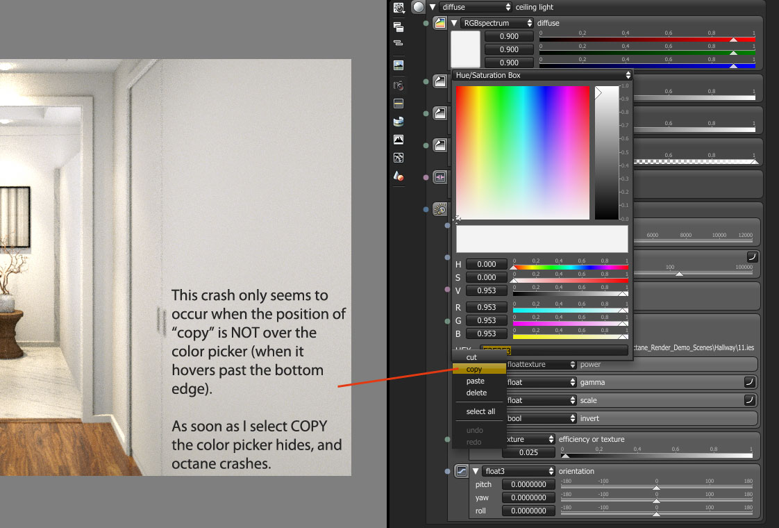

Found a crash bug and a non-fatal bug with the new color picker
Crash bug:
1. Load the demo scene "hallyway.ocs" (although any scene will do)
2. select the material picker and pick the ceiling light
3. Press the color swatch to bring up the picker
4. Click on the hex value to highlight it
5. Right click and choose COPY. As soon as I select COPY the color picker hides, and octane crashes.
Note: This crash only seems to occur when the position of “copy” is NOT over the color picker (when it hovers past the bottom edge).
See attached image
Bug 2:
Color picker values dont match the diffuse value in the side panel. In my image the diffuse value is 0.9,0.9,0.9 but the color picker shows 0.953,0.953,0.953
It looks like one of the values might be gamma corrected?
