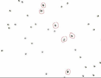

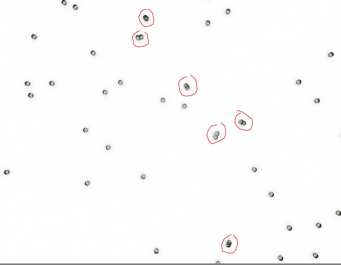

Does topology quality influence scatter distribution/concentration?abstrax wrote:Which distribution model did you use? Surface area and Relative density should produce better scattered objects. If you use one of these and you still have 4 on the same place, maybe there is a bug somewhere, in which case it would be good to have the scene so we can investigate.Zay wrote:When scattering an object, is there a way to avoid objects being scattered in the same position?
Here are about 4 objects (ferns) scattered in the same place.

It depends on the distribution method.Kalua wrote: Does topology quality influence scatter distribution/concentration?
- If you choose "Surface area" it will take into account the relative area of the polygons so it should generate instances uniformly over the surface independently of the topology, never multiple instances in the same place with empty space around like that.
- If you choose "Relative density" it will draw random locations in UV space, so maybe if some polygons are stretched/squeezed in UV space compared to world space it might result in unexpected distribution.
- If you choose "Vertex" and your polygons vertices are not welded together, it won't weld them, so you might get this kind of result if there are multiple vertices in the same location.
- If you choose "Polygon center" it will also of course be impacted by the topology.
There is no push-apart or collision radius to isolate instances from each other at the moment, so you will get intersecting instances if the density is high enough. It shouldn't be as extreme as in the screenshot though, especially when there is empty space around.
edit to add: for "Relative density", it also doesn't work well when there are overlapping triangles in UV space.

I use a surface (plane) with a relative density map. But I think the problem here is, if the painted map area is too narrow, you have to crank the density way up to cover the area and then it starts to populate in the same place or very close to it.abstrax wrote:Which distribution model did you use? Surface area and Relative density should produce better scattered objects. If you use one of these and you still have 4 on the same place, maybe there is a bug somewhere, in which case it would be good to have the scene so we can investigate.
I think adding a slider for "even space" will fix it.
Here is the bottom of a plane with trees scattered. Some are way to close or even intersecting. I will send a PM with the test file.
