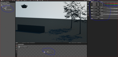

I tried 1.32 and got a few other issues.
See Images attached
1) when i export the scene although there are a lot of separate mesh's in the scene, all with materials applied.it only exports as one mesh without any materials applied
2) when i select edit first frame in the exporter . It actually stops on every frame.Even though i have selected the force close of Octane after render.
Anyways i'll try 1.35 to see if these issues are cured.

JimStar
Posts: 3847
Jaberwocky wrote:Jim
2 is fixed in 1.35.
I think that 1 - is the case of export preferences, check the checkbox "Ask export parameters" and try to set it first... Then you can leave "Ask export parameters" unchecked...
