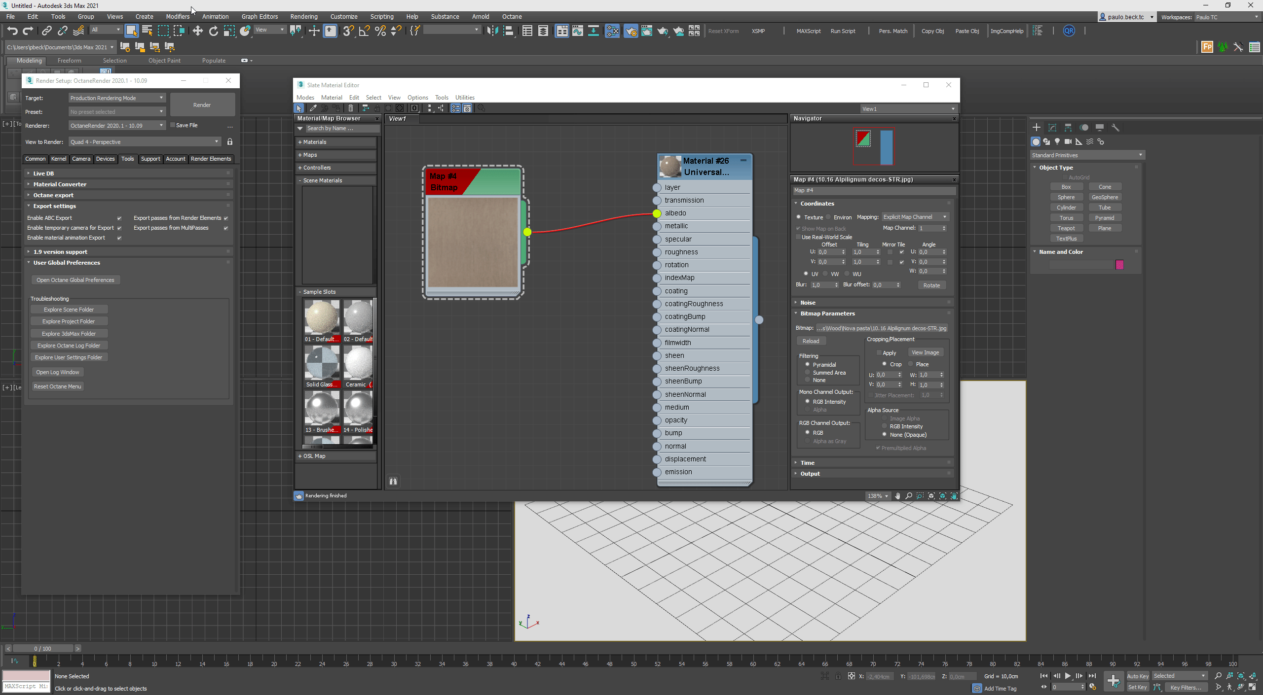

Hi samsue,samsue wrote:Hi
on my Studio subscription at home, Bitmaps are working just fine ... but on my Enterprise Subscriptio in the Studio, does not support Bitmaps ...
it seems to work in studio as in Enterprise.
Regards
Paride
I don't think so...
Update: The "problem" is it has to be activated "On-The-Fly Material Converter" There's not sense, at least to me... but anyway.

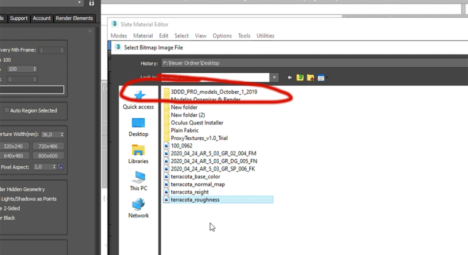

Showing off warez files from 3DDD on a screen recording is a bit out of place in a professional forum, don't you think Samsue? Most people paying for their stuff and not just downloading it "somewhere".
If you can't afford to pay for your 3D you may want to consider working in a different job instead competing with others who invest thousands of Euros as company expanses.
Plus cutting the income of the 3D artists who sell on 3dsky for 7€ a model.
Just saying...
Just saying...

mbetke wrote:Showing off warez files from 3DDD on a screen recording is a bit out of place in a professional forum, don't you think Samsue? Most people paying for their stuff and not just downloading it "somewhere".
Just saying...
my private PC at home it's one thing works pc another : ) and you pay 7€ really? I think the price is just 2€ ...

Hi samsue,samsue wrote:I don't think so...
It worked with or without On the fly to me, cannot figure out, i'm not sure it depends on it.
Regards
