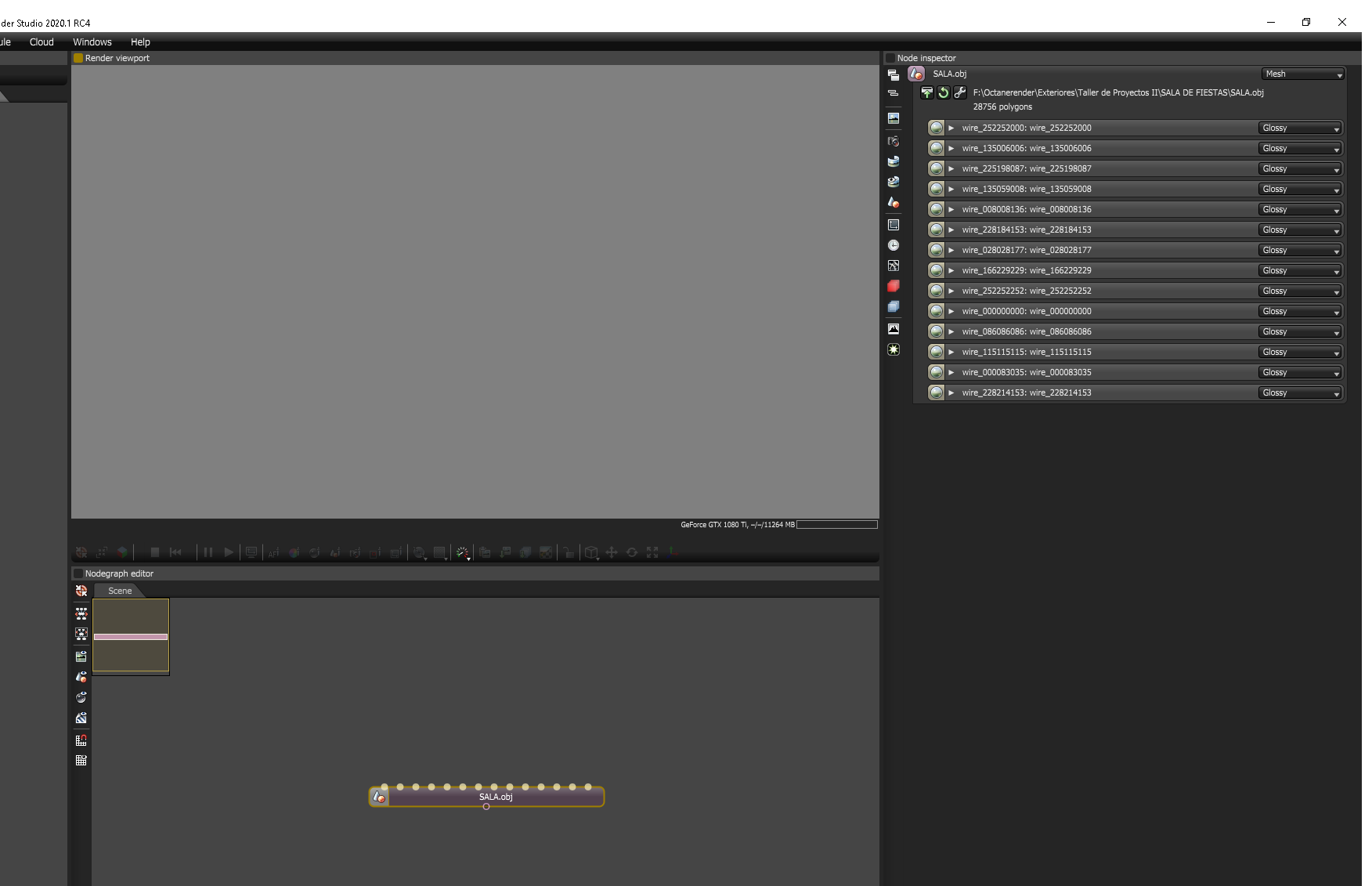

I HAVE PROBLEM, I TRY TO USE THE STANDALONE 2020.1-RC4 VERSION AND BY IMPORTING THE SCENE I SIMPLY SEE NOTHING IN THE RENDER VIEW
SOMEBODY COULD HELP ME ? ATTACHMENT FILE OBJ
THANKS TEAM OCTANERENDER
I CAN'T SEE THE SCENE INTO THE VIEWPORT

merid888 wrote:I HAVE PROBLEM, I TRY TO USE THE STANDALONE 2020.1-RC4 VERSION AND BY IMPORTING THE SCENE I SIMPLY SEE NOTHING IN THE RENDER VIEW
Try adding a RenderTarget.

merid888 wrote:GOOD EVENING
Right click on the gray part with the purple bar and then you can add items in the Node Graph Editor (NGE)
You literally can add a Render Target and then drag a line from the bottom of the OBJ 'node' int the Geometry connection on the Render Target. Then you double click on the Render Target to isolate it in the menu, and operate its options.
The double click also initiates the render of that Render Target.
It seems stupid, cumbersome, and not intuitive, I know....but you will soon love it, it opens a ton of flexibility that other applications do not have. To me its one of the better, if not best, 'node' workflows.
For example, you can set up 2 render targets and make one with daylight lights, and the other with a night look. Then you can click on one, then click on the other to compare the 2 resulting renders quickly without having to reset the whole thing. You can constantly do stuff like that.

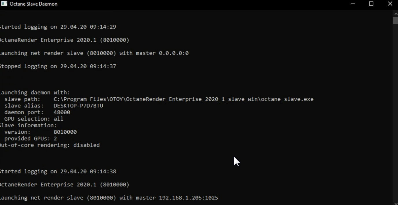

Yes, you misunderstood me. Before starting Cinema, befot master-slave story.
1. I installed the application Enterprice 2020.1 Slave on computer
2. I started Install_raemon.bat and executed all procedures needed
3. I start "Start Octane 2020.1 RC4 Daemon" and nothing happen
The console window appears for a moment and then disappears. Daemon not runs.

Did you get the chance to check the Windows task manager to confirm the daemon is not running? It usually creates a window that stays in the background. Also make sure the firewall rules are properly set to allow access to the local network.

mojave wrote: Did you get the chance to check the Windows task manager to confirm the daemon is not running? It usually creates a window that stays in the background. Also make sure the firewall rules are properly set to allow access to the local network.
Yes, the application is not running in the background. Task Manager does not show it. I previously used slave node and everything worked well. I checked this problem of two more friends and slave node also do not work for them.I think the problemrelated with the latest release update. Check it on your side please.
Posts: 10598
I have four 2020.1 Slave running here, on both Mac Win and Linux, and previously they have RC4, without any issue:
Are you able to render with Standalone 2020.1 on those machines?
Which kind of Nvidia driver is installed?
You need at least a version greater than 435.80. I’m currently using Studio 442.19.
