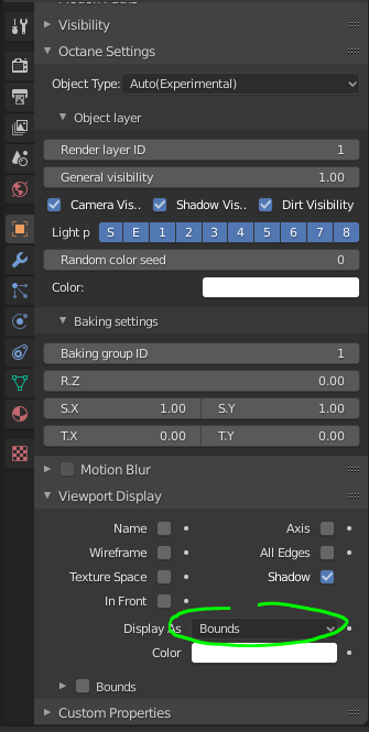

also, maybe my bad - but for example again volumes - when i have a box encompassing a scene, ofcourse it obscures all of the objects in it. there is no way i have found to hide the box in the actual viewport so i can see and move objects because if i hide the box in the viewport, its gone from the live viewer too.
This can be solved setting the Display As option to Bounds:
