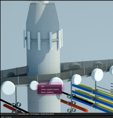

Jaberwocky wrote:
abstrax wrote:
Jaberwocky wrote:Sorry i meant the component names do not appear on the render vewport using the material eyedropper.
They do if you hover the cursor over the scene node pins , just not if you hover the materials eye dropper over the viewport.
Octane never did that, did it? Did that work in the past?
Thanks,
Marcus
well it did for me in the last Beta unless i'm going crazy :lol:
sorry yes i am going crazy ignore that.I mean when you just hover the cursor over the render preview screen you should get the part names up that the cursor arrow is hovering over , just like you do on the nodes in the node screen.
Not having a good day here. ;)
Marcus
Sorry , my report above was wrong.The Preview render pop ups are working.I was using the l.h.mouse button.I should have been using the r.h.mouse button....OOOPs!!!! :roll:
