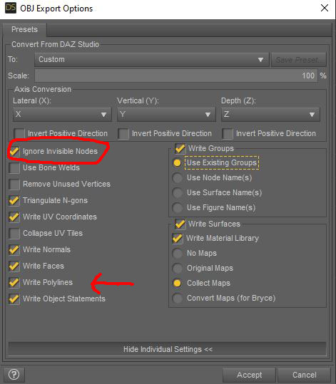

Don't unparent the hair , just make the figure and all you don't want to export "invisible" by clicking the eye button in the scene manager.
In the export window click "Ignore Invisible Nodes" and " write Polylines", now it's only exporting the hair with the right pose.
I have the same problem like you that the hair is rendering and not , my workaround is to export the hair as "Obj" and the animation as MDD.
Importing all to Cinema 4d via " Riptide Pro" as "Ngons" and saving the whole animation as "Animated ORBX". It works fine , but the files are huge , up to 30 GB a 15sec animation.
The hair looks really great and I hope Octane for Daz can handle it in near future.

Thanks Man this was really helpful... I'll give it a try

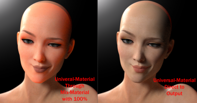

I'am encountering a problem with the universal material while playing and testing around. If i put the universal-material through a mix material and set the greyscale to 1 if it is in the first slot or to 0 if it is in the second slot it becomes "glowing". If i put it direct to output without a mix-material it appears as i expect it to. Is this a bug or does the mix-material some other magic to universal-materials?

Hi. I think this is an Octane issue, as I have seen a similar issue reported to OTOY. Hopefully it will be fixed in the next Octane release.
