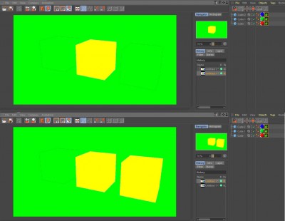

poison wrote:AHMET , one big THANK YOU for your effort to making it very stable for my setups in R20.
Had some OpenGl issues with R19, but this is not octane related.
Anyhow, i have run into some tricky issues with Cryptomate in this update release.
Render setup:
Cyrptomate channels: CryptoMaterialNode, CryptoObjectPinName are checked
1) scene being rendered, eg frame 1-200
2) on frame 100, i stop rendering.
3) resume from frame 100 ...
4) Cryptmate channel CryptoMaterialNode is different from that point onwards.
this is complicated, cause in post i have to deal with reselecting the materials from that frame onwards.
is this supposed to happen ?
You're welcome but are you talking about a specific scene? Sample scene would be appreciated, can't know what's happening without seeing.
Ahmet goodmorning. Unfortunately it is NOT project related. As you can see in the supplied test scene, the MaterialNode is the same , but the CryptoObjectPinName is different. 3 tags are the same.
Thank you for your time.

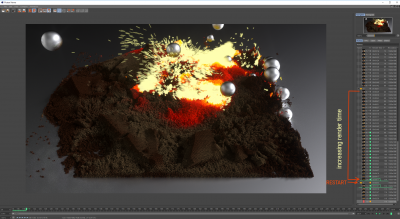

Hi Ahmet. I had a problem while I rendering a lot of particles. Octane render time is constant per-frame, but frame-processing time drammaticaly increasing frame by frame. Scene consist same quantiti particles in every frame, but render time increasing for 2 times after each 10 frames. But when i restart render, render time going small and start increasing again. On screenshot you can see when same frame (114) can render 4:17 and after restart 1:01. It's a madness. (x-particles are cached)
Is it Cinema related problem?
Posts: 16068
Location: Türkiye
divasoft wrote:Hi Ahmet. I had a problem while I rendering a lot of particles. Octane render time is constant per-frame, but frame-processing time drammaticaly increasing frame by frame. Scene consist same quantiti particles in every frame, but render time increasing for 2 times after each 10 frames. But when i restart render, render time going small and start increasing again. On screenshot you can see when same frame (114) can render 4:17 and after restart 1:01. It's a madness. (x-particles are cached)
Do you have motion blur? Send me render logs from Console window.
