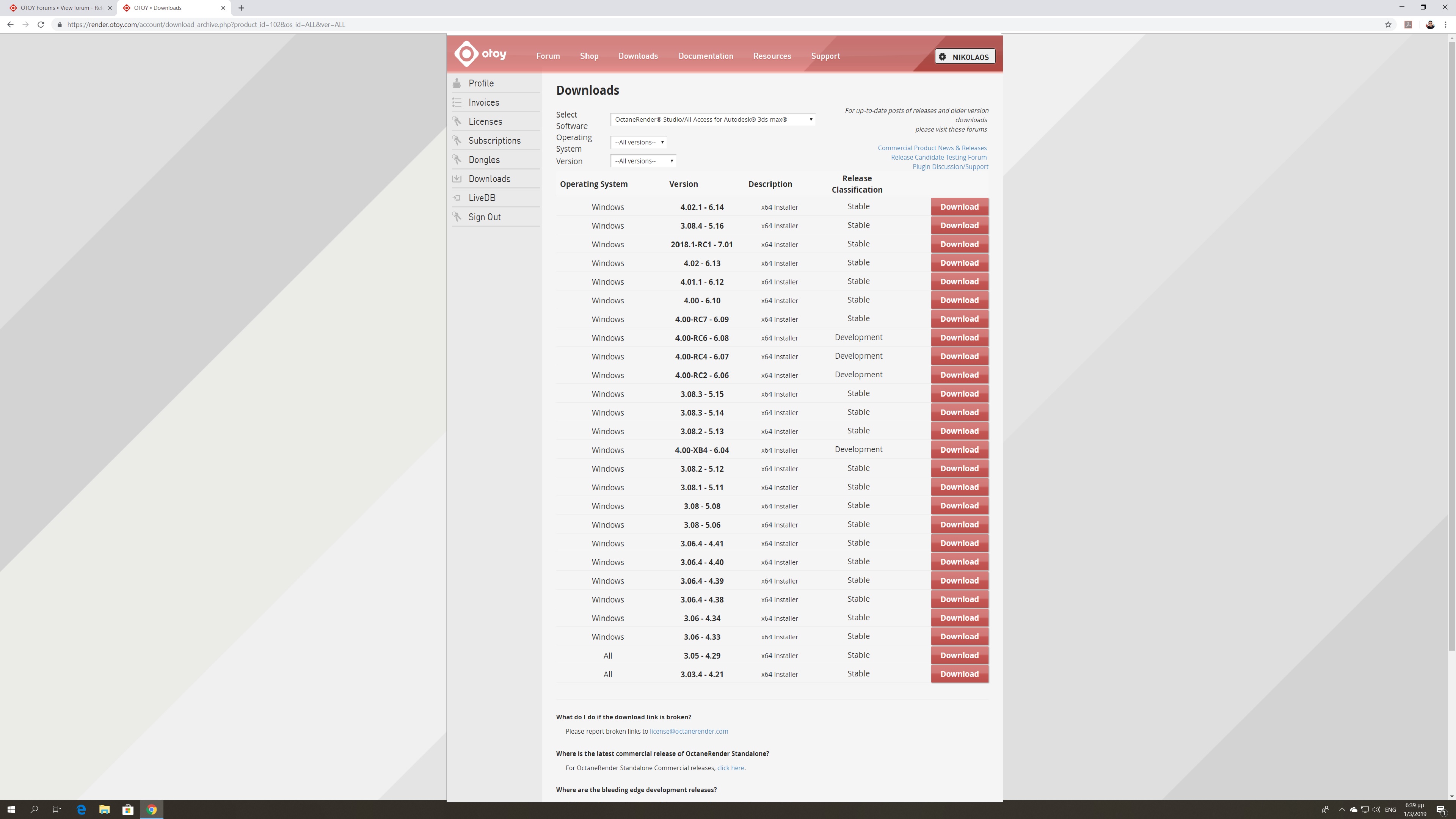

I can download 4.02.1 - 6.14 or 3.08.4 - 5.16. Is this newer version than 7.01 ?paride4331 wrote:Hi nick73,nick73 wrote:Hello,
my 2018.1-RC1 - 7.01 studio - all access has expired two days ago and asking for a newer version, but there is no one available in downloads page. Please make this one available for subscription or allow keep using 7.01. Thank you.
you can find it here:
https://render.otoy.com/account/downloa ... oduct_id=1
Regards
Paride
2018.1 RC/ is lastest.
Then 4.xx
and oldest is 3.xx
Then 4.xx
and oldest is 3.xx

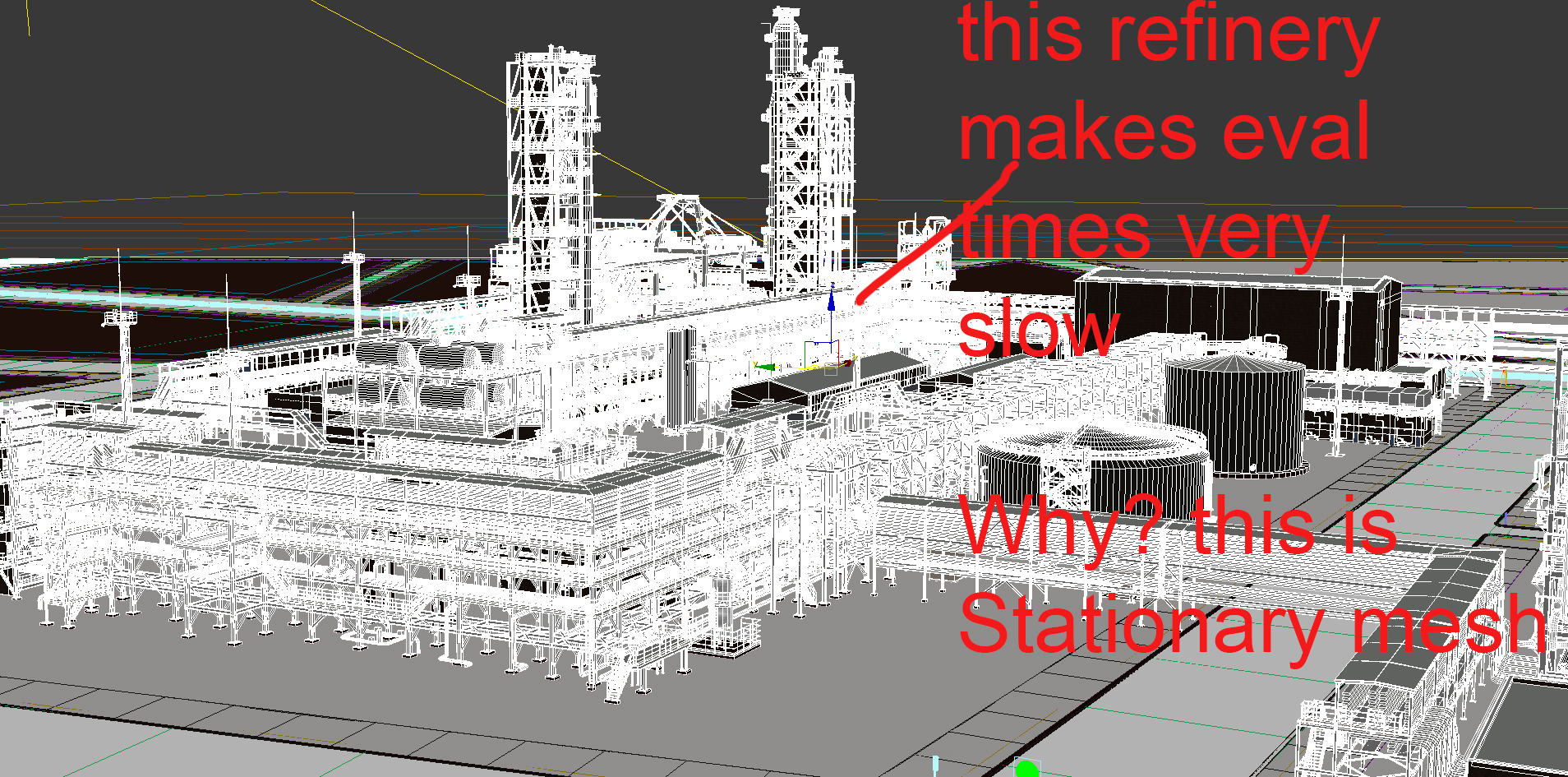

Hi Paride,
I sent you the scene with slow eval times as PM. Still 35 seconds per frame. Could you guys please fix this bug already.
We also used city traffic 2 in the scene. Link to it http://forum.rendering.ru/viewtopic.php?f=8&t=1428
UPDATE:
Hiding itoo didn't change loading times every frame. The bug points out to the refinery mesh in the scene. It does have a lot of polys but this is a stationary mesh and should be loaded only at frame 1 but for some reason every frame it makes eval times slow
UPDATE2:
When setting this refinery as a movable proxy it evaluates faster. Eval times went from 35 seconds per frame to 6 but then you guys told us stationary objects should not be set as movable proxys. So should we or not set the whole scene as movable proxy? Should buildings be set to movable proxys? Should itoo be set as movable proxy? This looks like a bug
Thank you.
UPDATE:
UPDATE2:
Thank you.
- neonZorglub
- Posts: 1090
- Joined: Sun Jul 31, 2016 10:08 pm
Hi coilbook,coilbook wrote:Hi Paride,
UPDATE:
UPDATE2:
Thank you.
I suspect that some modifier in your big stationary mesh could incorrectly trigger a rebuild; I'm looking into it, as well as the other reported slowdowns..
You could keep those objects as movable proxy for the moment, and in the next version, setting it back to non movable proxy should be more efficient.
Thanks for your scene.
Update:
It is more likely that one or mode object in the scene is animated, but not set as movable proxy.
This forces a rebuild of all objects of the static mesh.
You can disable this by unckecking 'Update anim. geometry' in the Kernel settings, making all non movable proxy really static while rendering an animation.

I set, as I told many time, All movable proxy then:
unchek update anim. geometry
time 3 secs.
Please you always do that, all movable proxy.
especially with big scene and network render.
Regards
