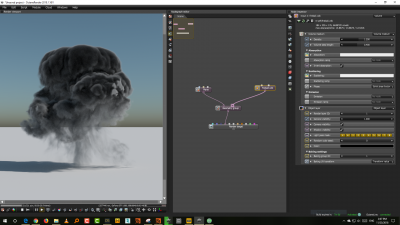

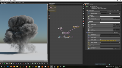

There seems to be a massive difference between the volume render look of Octane 4 and 2018.1. Same light bounces including volume bounces for 2018.1 and same shader settings. The top one is 2018.1 and the bottom is Octane 4.

rohandalvi wrote:There seems to be a massive difference between the volume render look of Octane 4 and 2018.1. Same light bounces including volume bounces for 2018.1 and same shader settings. The top one is 2018.1 and the bottom is Octane 4.
There is a way to switch between the new and old volume rendering systems as mentioned in the release notes.
