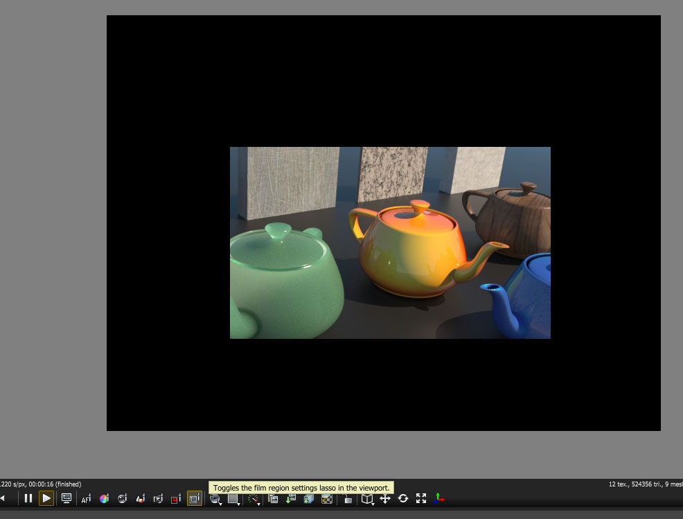

To be sure we understand each other, I'm attaching screenshots:
OC4 RC4 and earlier - Region Render doesn't clear all around:
versus
OC4 RC6 - every time Region Renders is enabled or changed/moved it clears everything around:
We need older functionality back
3dsMax Film Region Picker works exactly like in SA.
I will ask to developers if possible to have previous preview around.
Regards
Paride

OK, looks like that in 3ds Max we have Film Region functionality instead Render Region.paride4331 wrote:
Hi kcpr-raffaEl,
Regards
Paride
So, can we have Region Render instead of Film Region?
