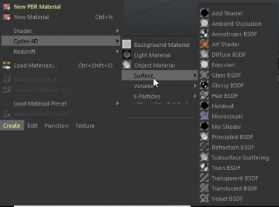

aoktar wrote:
Studio21 wrote: Ahmet perhaps its a good idea to have the specular map at 1 as default?
Not because it's not a metallic material by default. Specular_map will be 1.0 if you create by "create metallic material" command.
I have to agree specular map should always default to 1. There are only two types of materials that use the specular map, metal and the universal material. Universal material is typically going to be based around a PBR workflow which would include using a texture map to drive the metalness which will override the default the value. There is no reason not to have it default to 1 since it won't affect any of the other material types. Metal material is not a dropdown in the create material tab, if it was it would be easier to get used to creating it that way. Creating materials from a dropdown in the live viewer has never made sense to me, most people create materials from where where they manage them. I have included a screen shot of what Cycles 4D does for the create materials tab. Would be nice to have the ability to create the material presets from more then one location. Also would be nice to have its own menu instead of being inside of shader.
