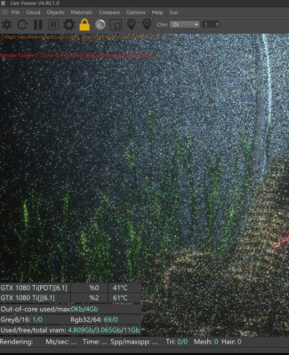

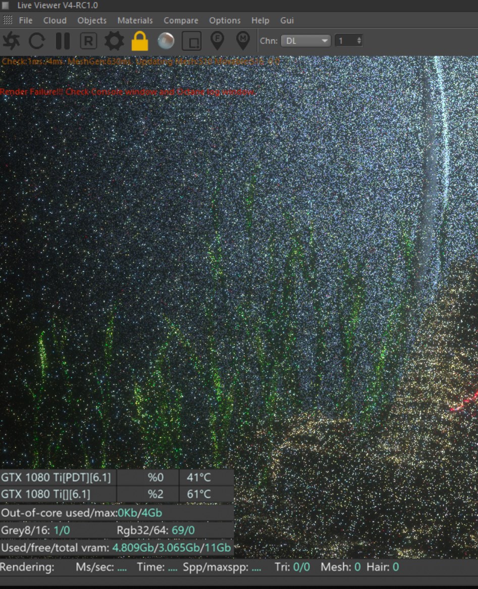

At first render freez and LV look like this:
download/file.php?mode=view&id=69392
After resend LV shows this:
download/file.php?mode=view&id=69393

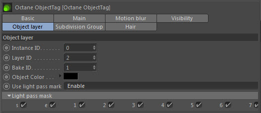

I am looking through the patch notes, so I apologize in advance if I missed it, but is Light Linking in this build?
I can't seem to find any settings through C4D, Octane, or Octane tags.
Thanks for the update though! I am running tests with the AI Lights and the Denoiser, everything is working great so far!
-Inky
-Inky
Inky wrote:I am looking through the patch notes, so I apologize in advance if I missed it, but is Light Linking in this build?
-Inky
Thank you! That was my bad, it wasn't totally straightforward. This is great! Very much appreciate this feature!aoktar wrote:Inky wrote:I am looking through the patch notes, so I apologize in advance if I missed it, but is Light Linking in this build?
