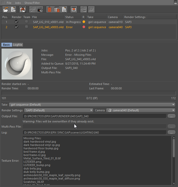

Hi everyone. Sorry if it´s a dumb question but I couldn´t find an answer by searching for it. Where are the textures for materials downloaded from the live DB stored locally?
Whenever I add a scene to the render queue, it gives me an error because it can´t find any of the textures associated with LiveDB materials. I tried doing a Save with assets, but the same error happens.
Any help will be appreciated. Thanks!

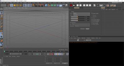

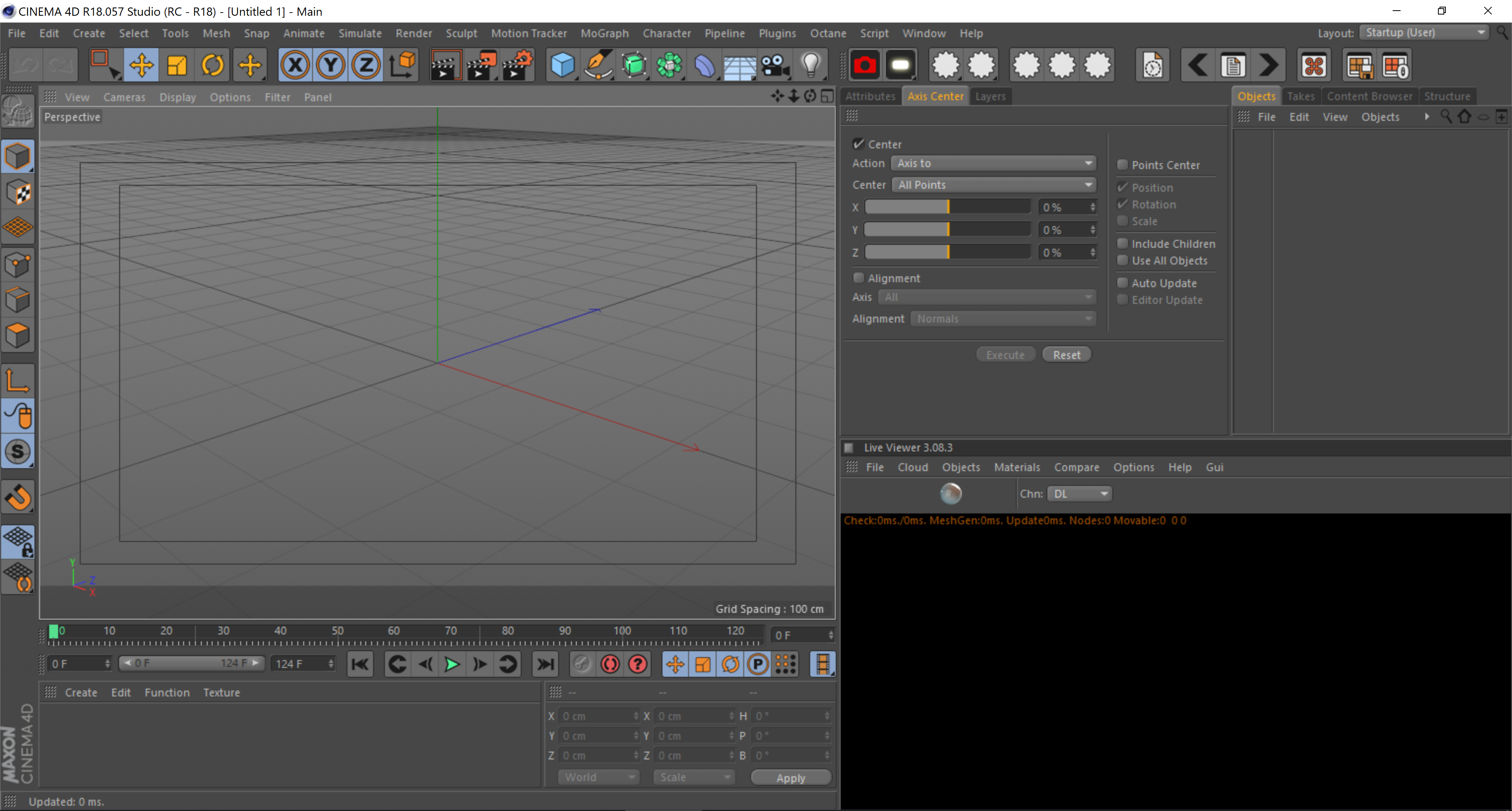

I've run into a very weird issue after installing the 3.08.3 plugin. I'm using Cinema 4D R18 and with the new Octane plugin the UI is more or less gone. Have a look below:
All the icons are gone, the Octane menu in Cinema 4D's top menu bar is completely empty and adding anything the live viewer menu causes C4D to stop responding? I've deleted and reinstalled the plugin a bunch of times, restarted my machine etc, but nothing fixes this issue. What am I doing wrong?
Thanks for your suggestions.

Did you carefully read instal notes? You should copy the whole content of package under to C4D/plugins location.
