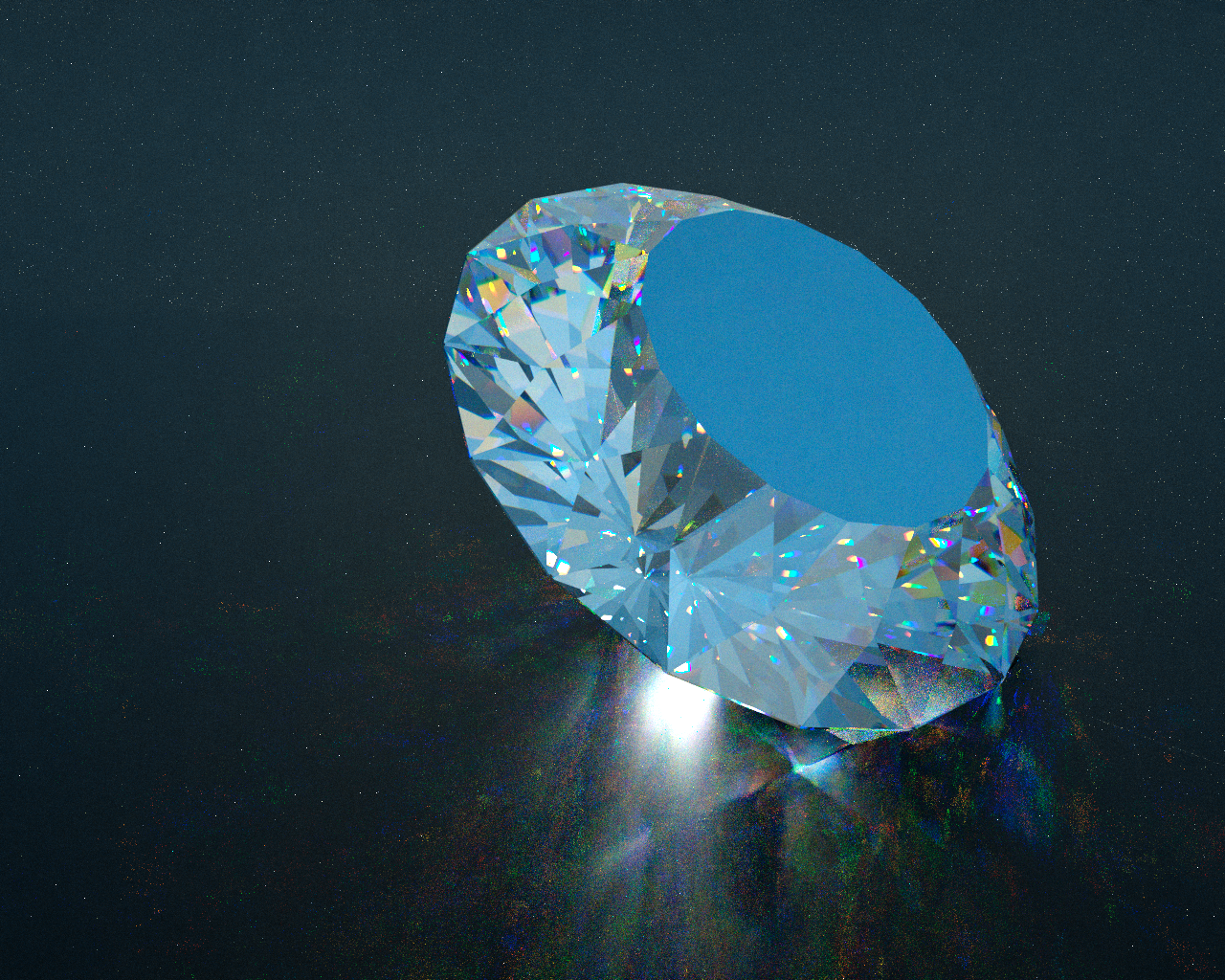

The new caustics are amazing. This is a very simply scene and the refraction through the diamond is amazing.
1500 samples, 22 minutes
