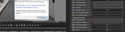

funk wrote:
justix wrote:
funk wrote:Looking awesome OTOY!
I just tried the denoiser using the built in material ball scene and it crashes though
EDIT: yeah starting a new scene, adding a render target node and activating denoiser = crash here :(
I think there must be a problem with the current RC 3.08 release in exporting because I have no problem with an old export than 3.08 as it crash on my 3dsmax plugin too
Well Im just adding a render target right in standalone. So not loading any old scenes
I couldn't reproduce the issue. Was the crash happening right after denoiser was enabled or after some samples?

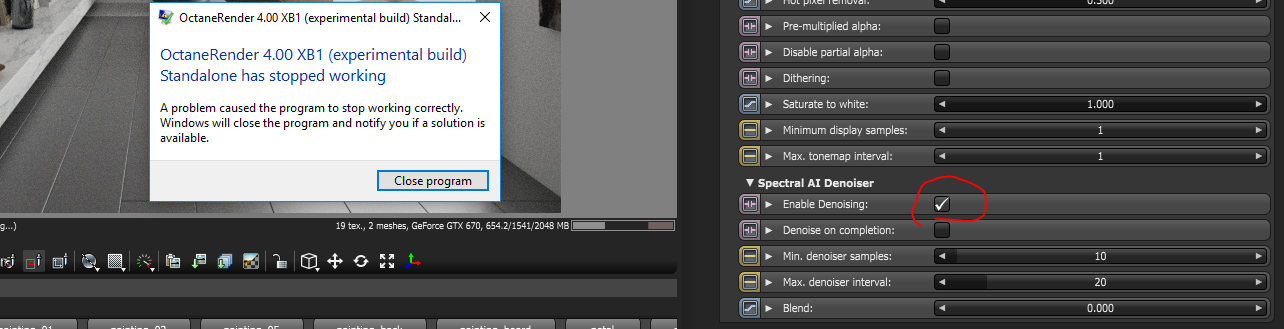

funk
Posts: 1207
Joined: Mon Feb 07, 2011 1:24 pm
Location: Australia
vijay_thirukonda wrote:I couldn't reproduce the issue was the crash happening right after denoiser was enabled or after some samples?
While rendering, I enable imager > enable denoising. After a couple of seconds, I see my windows 10 cursor turn to the blue spinning circle, then it crashes
Could this be due to drivers? Or is my hardware too old (gtx 670)? Im on driver 388.31

vijay
Posts: 196
Joined: Sun Jul 24, 2016 8:42 pm
v-cube wrote:
Yes 4K x2k limit at the moment
Ok... and I thought I was too stupid... why did you give it a limit?
Best
Andreas
Current AI model's memory usage is slightly high(experimental build), we already have plans to reduce it. So, for now, try dedicating a device only for denoiser and/or try scenes with low resolutions.
Sorry, This should have been in the release post.
