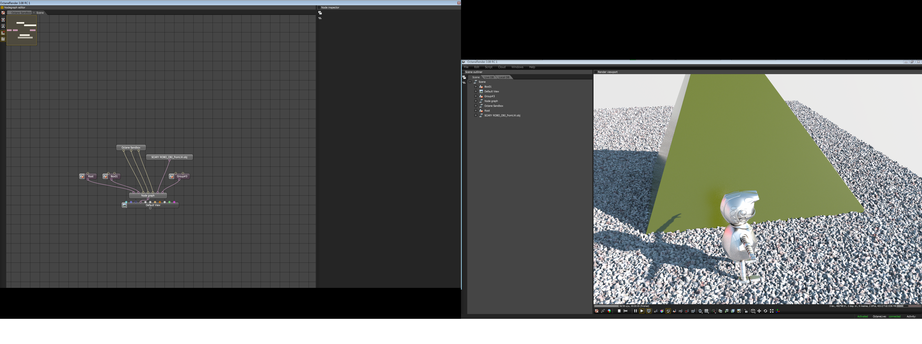

johlanga wrote:Materials lousing link to Octane Sandbox all the time. And I have to use the "Rearrange....button" konstantly.
This make SU plugin impossible to use!!!
Back to not using materials > see Clay mode with glass/specular.......
PS: No crashes yet ;)
Hello Johlanga,
Thank you for the test scene! We will examine and evaluate a potential fix as soon as possible.
Cheers,
Azen
