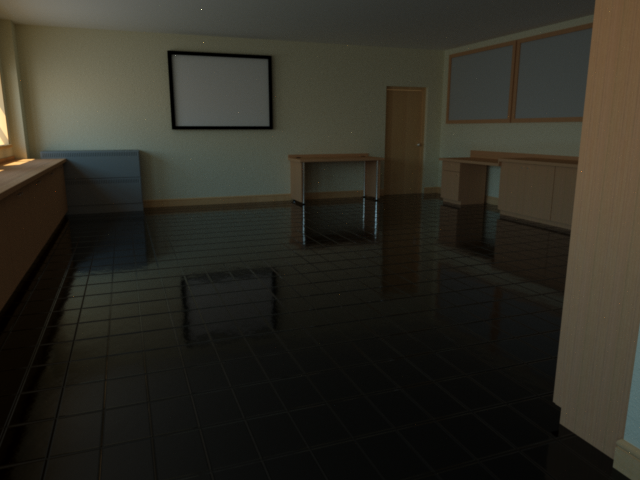

I tried out a hot pixel test on a class room scene.Stuck in a black ceramic tiled floor ( not normally something you'd see in a classroom ;) ).with daylight into one side of the room and diffused painted walls.Normally a recipie for lots of Fireflies.There were some but overall not as bad as i expected over a cooking process of 21000 samples / 1.5 hrs.The attached has not been altered in anyway and the hot pixel removal tool was not used so that you can see the outcome.

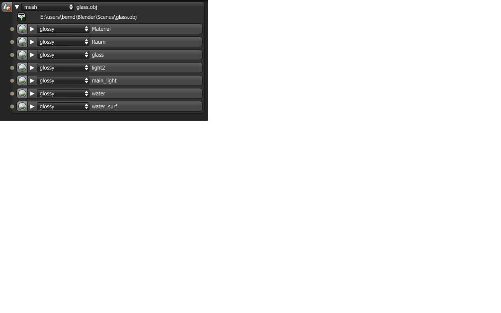

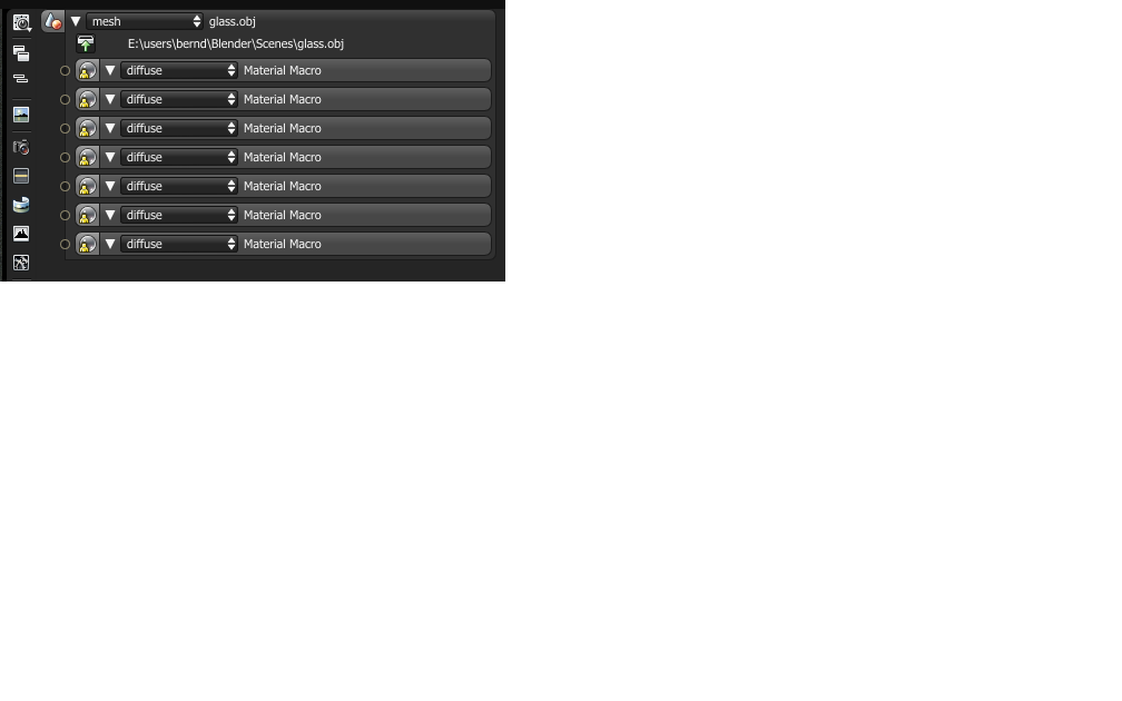

- when i add an material to a object node, the object node is given the name of the material. very annoying (many materials from livedb have the name "Material Macro"
- No tool tips when hovering over an node
Before:
After:

garak wrote:Hi,
Before:
After:
Cheers
Bernd
As far as I can see, nothing has changed to previous versions. I have made a fix now, that when you drag a material from the LiveDB onto the node graph editor, it gets the name of the LiveDB entry and not the original name the macro had, when it was added to the LiveDB. I hope that is ok.
