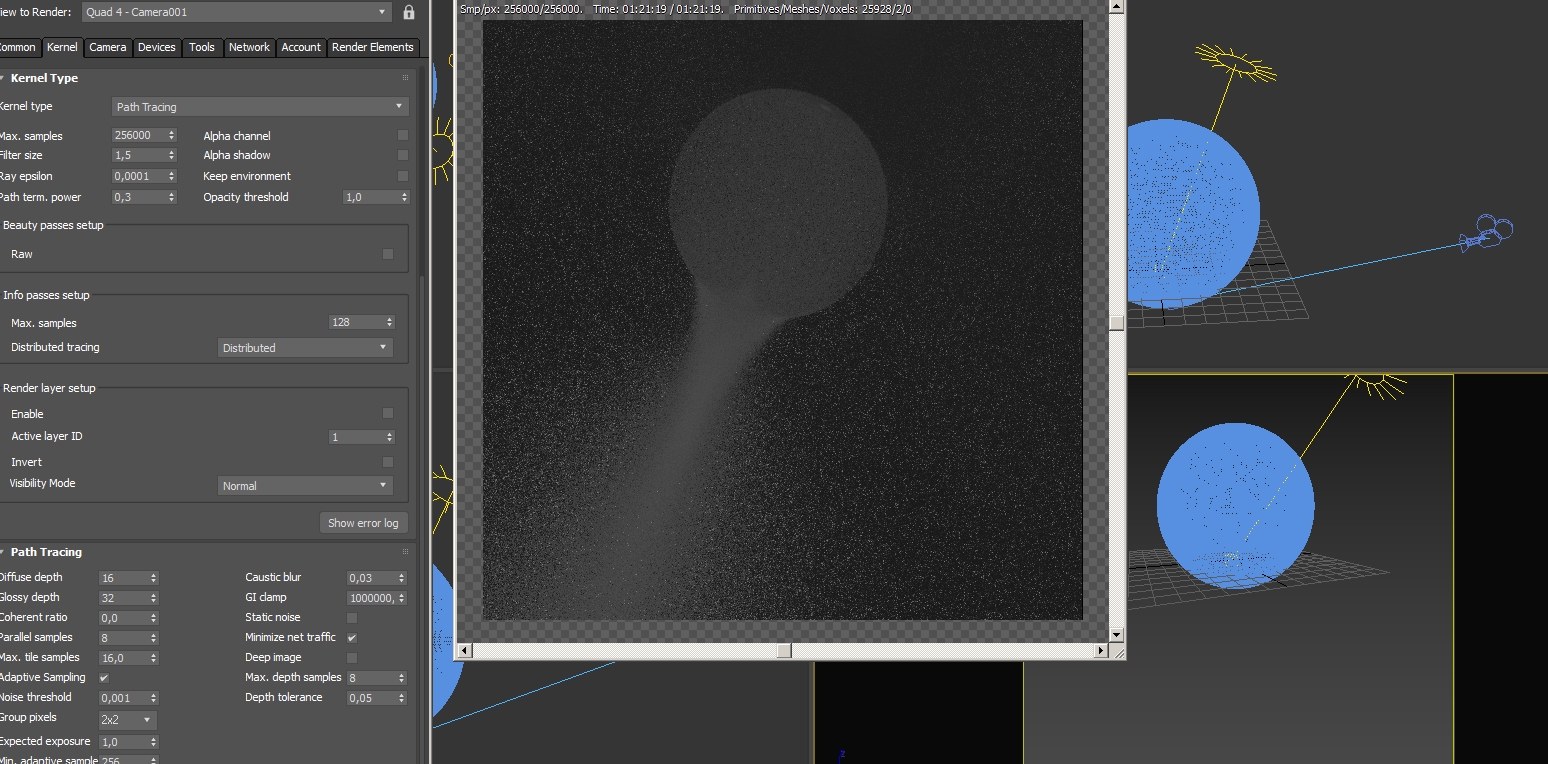

Here is an example.
What to do to avoid noise?

mikinik wrote:
bepeg4d wrote: Hi Elvissuperstar007 and Goldisart,
as always, is not so easy what are your needs exactly, at least for me :roll:
Do you need to remove the coustics?
In general, you can cut the coustics with kernel parameters in PT and PMC, while in Direct Light there is no coustics calculation.
Do you mind to share an example orbx scene to better understand which settings are you using?
ciao beppe
Here is an example.
Do you get the same noise levels if you increase the resolution of your sphere's geometry?

mikinik
Posts: 221
Joined: Sun Oct 07, 2012 1:05 am
mojave , that helped a little. but the noise is still there.
You can remove the restriction on max.samples? For what purpose this restricted?
orbx - https://www.dropbox.com/s/8t18y3tcgf5md ... .orbx?dl=0
