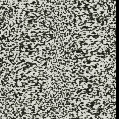

Is it possible to convert procedural octane noise to bitmap and then use it for displacement. We just don't want to deal with manual texturing of objects since proderual does it right away thank you.
Posts: 10630
Hi coilbook,
if the mesh has proper unfolded not overlapping uvs, then you can use the Octane Baking feature to bake any kind of procedural textures applied, like noise, dirt and so on, and reuse them, also as displacement.
ciao beppe

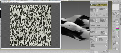

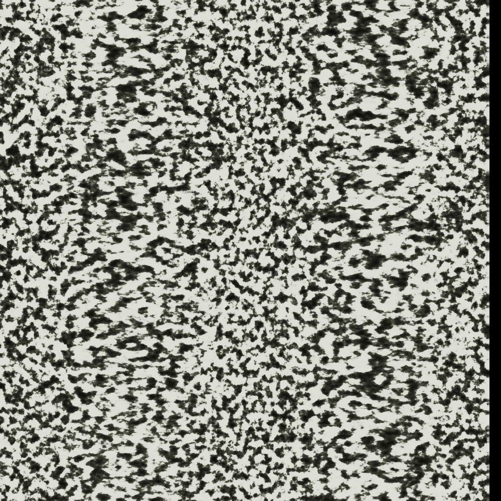

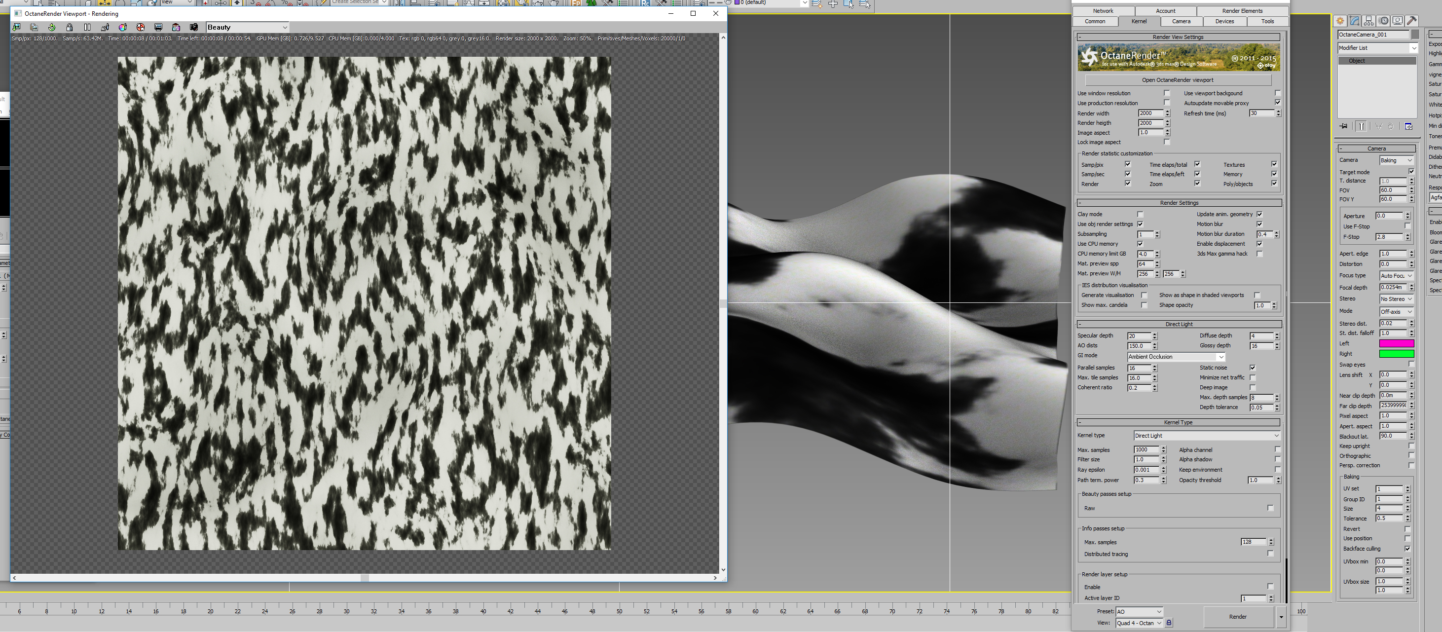

what is a proper resolution for baking. Seems like changing aspect ratio changes texture look. Like aspect ratio? In this example I am baking a rectangular plane with noise

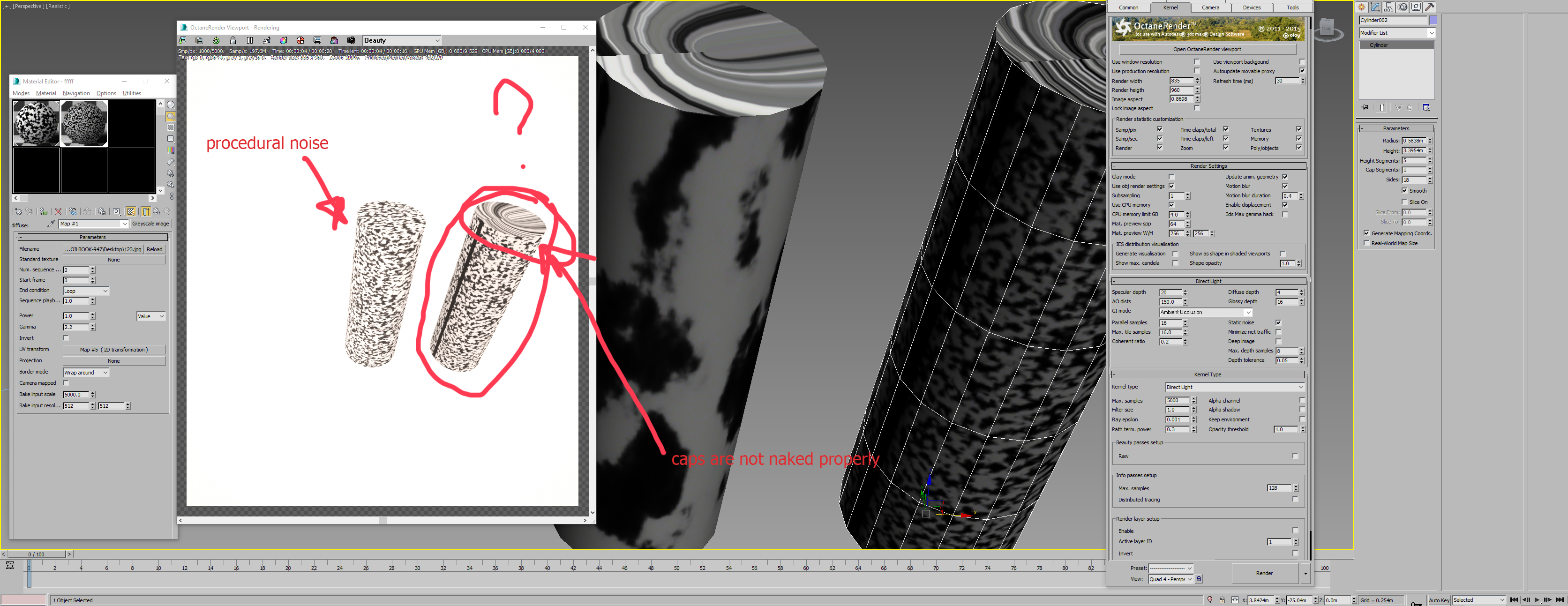

Why did not cylinder create a proper texture with proper textures on cylinder caps? Same happens with the box.

coilbook wrote: Why did not cylinder create a proper texture with proper textures on cylinder caps? Same happens with the box.
I think the problem is that you don't have UV geometry mapping the cylinder caps, or at least that what it looks like to me from the baked texture.
You also need to make sure both geometries, the one you are baking from and the one you are mapping the texture into have the same UV set, otherwise the mapping won't match.
If you are not sure, could you share the wireframe view of your geometry using the baking camera?

Thank you. We really thought Octane can automatically map for us since procedural textures on cylinder looks fine and it will create a matching bitmap with mapped caps. That's was the whole point for us is not to deal with mapping and let octane do all the work.
Thanks for explaining.
