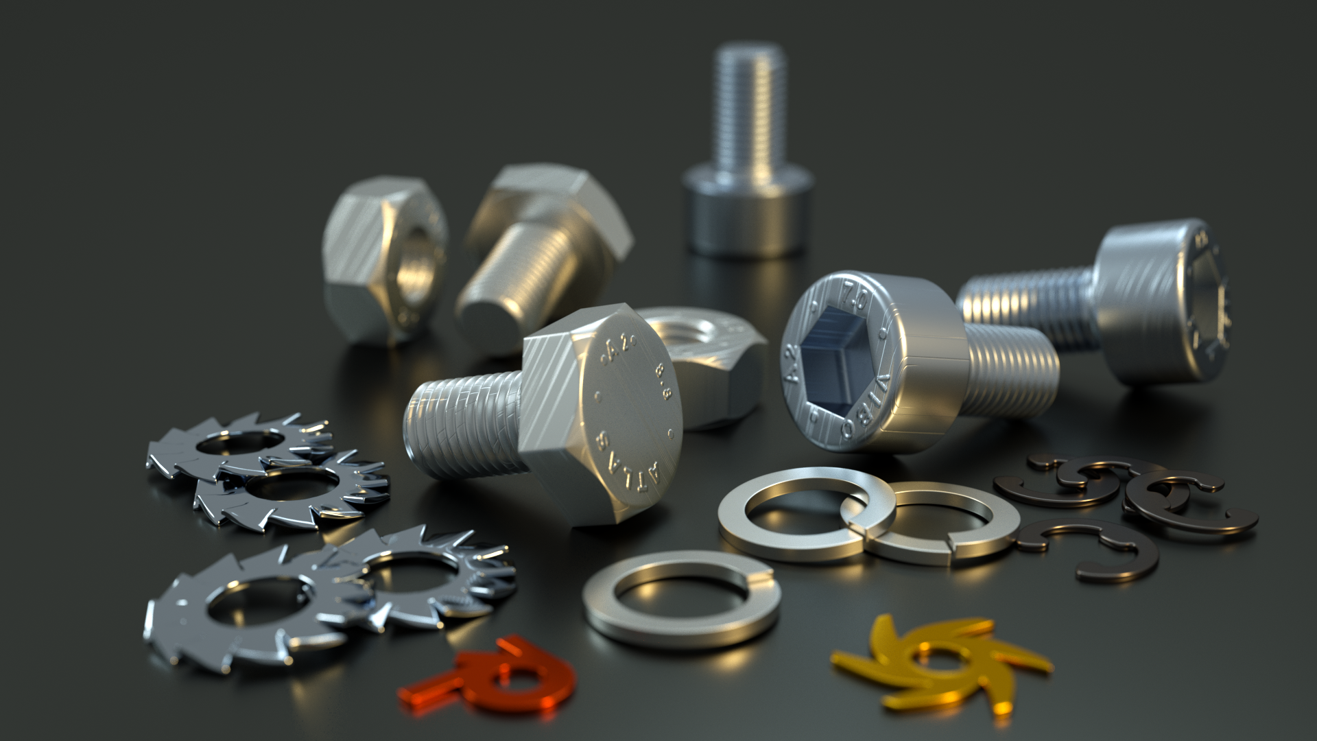

Wow, this has me really excited. I'll admit, I typically only use the Octane plugin with Cinema 4D, but this new feature got my curiosity up so I opened standalone for the first time in forever and loaded one of the demo scenes.
AS enabled. 30,000 samples. 10:50 seconds. GPU: GTX 970 and GTX 980 ti. I didn't do a comparison with AS disabled, but the ETA for 30,000 samples was around 40 minutes.
OctaneRender™ Standalone 3.06 TEST

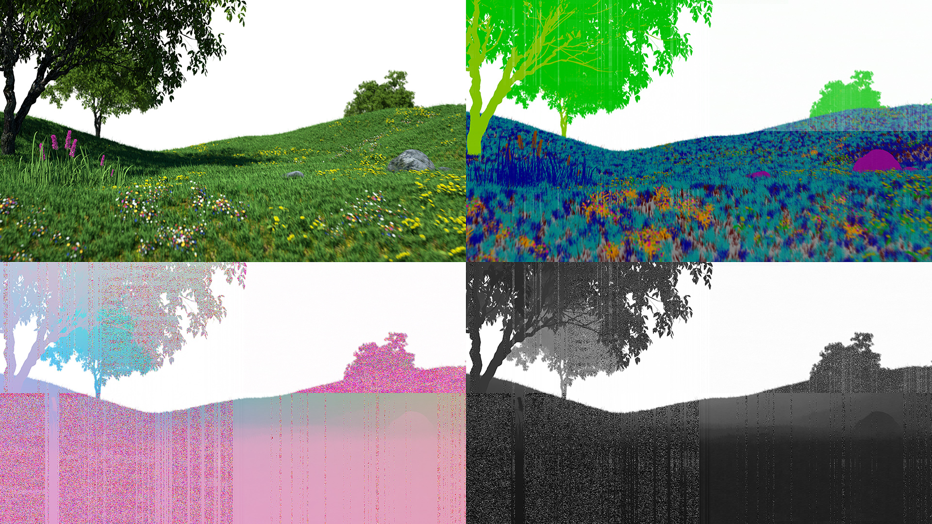

Got a very strange result of rendering the animation sequence (rendered with passes, saved as separate PNG sequences, AS enabled). I'll try to figure out what was going on and give more detaied description.
