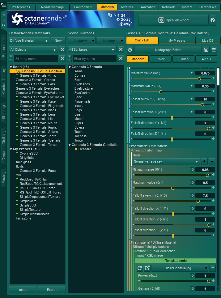

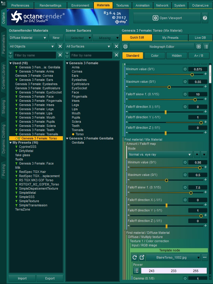

Without doing anything else, the shader is very very different. The gens have a gray scale 'power', while the torso has a colored texture. I believe that means the wrong shader was loaded.
In Octane Materials I then selected all the textures on Genesis 3 and Gens and did a 'Replace All Active Maps'. In render, the gens are clearly a different color.
If I manually change each difference (10? total) the gens have to the torso to the torso's values, render is flawless.

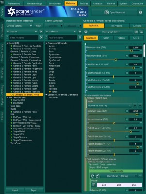

I have uploaded two pictures of the top of the redspec shaders so that you can see that they are different and will cause some serious discoloration.
Torso
Torso Texture loaded and active maps replaced.
Gens
Gens Texture loaded and active maps replaced.
