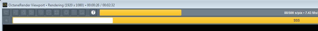

After enabling Beauty Passes and clicking on a beauty pass to view, sometimes the button to return to the Main Beauty Pass becomes disabled. The only way I've found to fix is to close DAZ Studio and reopen.
I could reproduce this error - I will see if I can fix it.
This is fixed in the next release of the plugin. In the meantime, turning off all render passes with take you back to viewing the main beauty pass.

Thanks, Paul. I did find the workaround you mentioned. Unfortunately, it restarts the render, but it is more convenient than restarting the application. Looking forward to the next release! :-)
