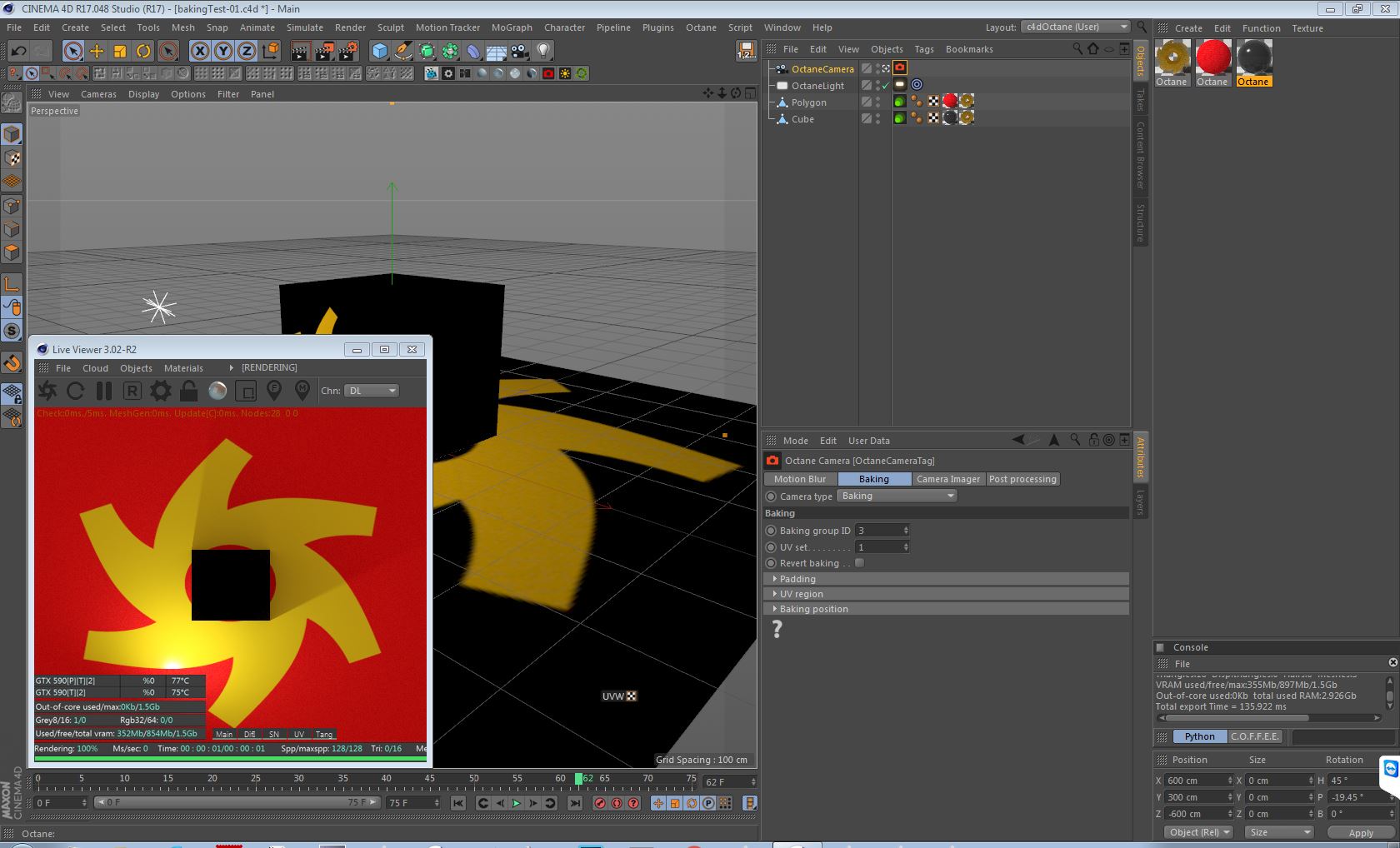

It seems that bake system doesen`t work with area light..
PS Any chance for deep pixels? V3 itself is a poor release.
Posts: 10661
Hi arsen,
please double check your uvs, no problem with area lights and baking camera:
ciao beppe
arsen
Posts: 15
Joined: Tue Sep 27, 2011 6:59 pm
bepeg4d wrote:Hi arsen,
ciao beppe
thanks, i found that area light must be set in another(than mesh) Baking UV group

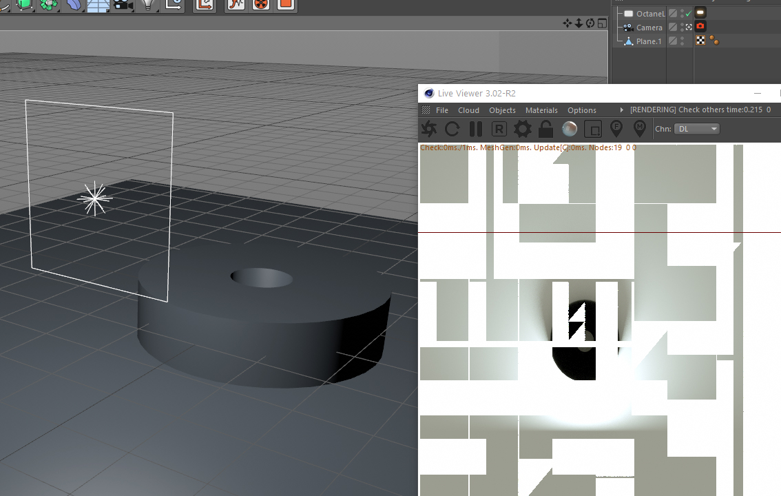

Hi aoktar,
I noticed a maybe strange behaviour of camera motion blur.
When I enable motion blur in a camera, while perspective correction is enabled, the perspective correction gets "inactive" in the viewport, means the liveview is no longer perspectivly corrected.
Is this a bug or some C4D or octane limitation?
(Using your last 3.02 R2.
I need perspective correction for an animation...
Thank you.

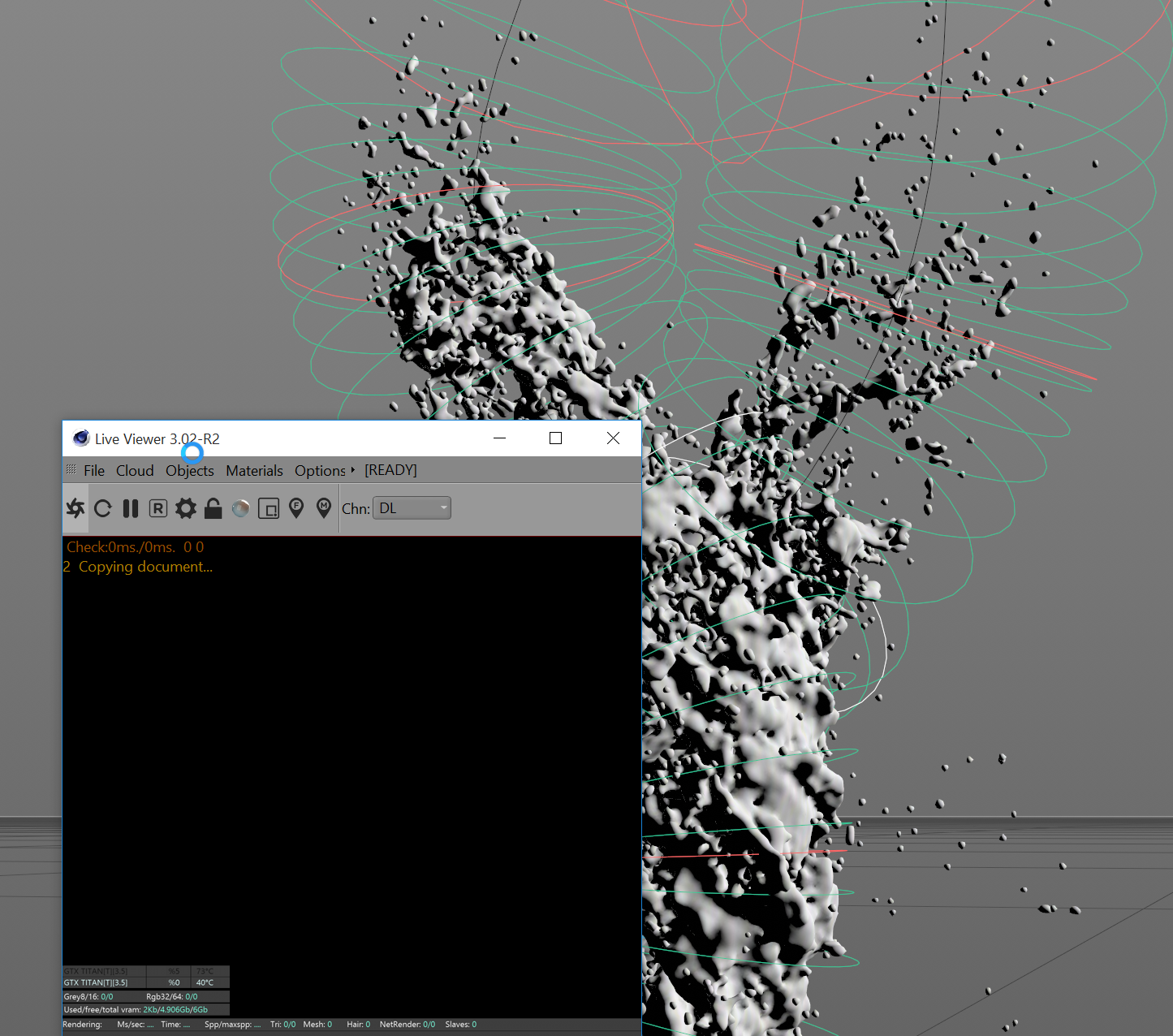

Realflow For C4D Sale was a start. You can try Trial(1month).
It attempts to render Cached Mesh(It is "Alembic Sequence". Not Single Alembic File)
When Start Render. Octane Render is Hang and doesn't response. :oops:
PS
Render to PictureViewer is OK.
