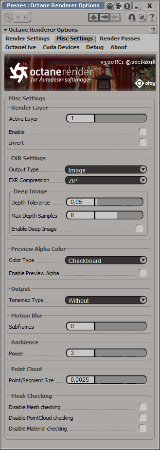

Have updated the Misc settings under the render property a little bit.
Included are the "Render Layers" and the "Render Preview" tab, also some settings for the exr image output.
The "Preview Alpha Color" group will only be visible if alpha channel rendering is enabled under the "Render Settings" tab.
In the "EXR Settings", the "Deep Image" group is visible if the render kernel is set to direct light or pathtracing and the EXR output type is set to image.
So you can only save the current rendered image, or if some passes active, the current selected pass, as deep image.
Other options for the EXR output type are passes and passes multi, which will save all passes, if present, as single files, or with passes multi, all passes in one exr file.
If you want to save some passes, then you can also create a project file, which can be used with the otoy Photoshop plugin. In this file, all blending information are written.

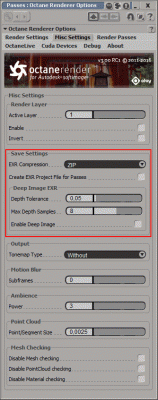

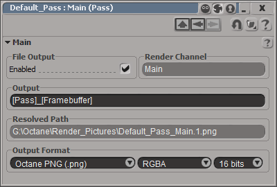

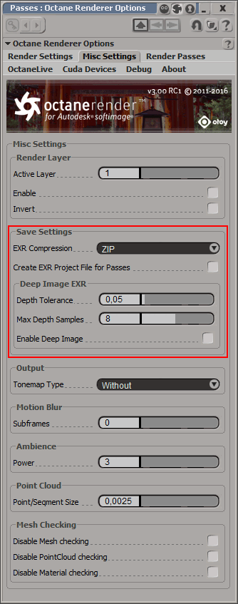

Ok, have modified the save settings a little bit. It looks now like this:
The background was to know, how the image should saved and i have done it via the pass output format.
Output can be png rgba 8/16bit, exr rgba float/half float and exr layerd float/half float.
Now i try to explain it a little bit deeper.
No render channel, the filename will be:
Default_Pass_Main_Beauty_Raw.1.png/exr
One render channel, the name will changed to:
Default_Pass_Main_Beauty_Reflection.1.png/exr
Depent on the channel. If you have select layered exr, the image will change to non layered exr, because it has only one channel.
More than one channel, the output becomes as example:
Default_Pass_Main_Beauty_Diffuse.1.png/exr
Default_Pass_Main_Info_Z-Depth.1.png/exr
Default_Pass_Main_Mat_Opacity.1.png/exr
The layered version will be:
Default_Pass_Main_Multi.1.exr
If you have enabled deep image in the render options, you will get:
Default_Pass_Main_Beauty_Deep.1.exr
And it will be saved in the same folder which the first output uses.
You can mix various output format together so you can get different results like this:
Default_Pass_Main1_Multi.1.exr
I have included it in this way, also the render channels itself, because it makes no sense to include 50+ render channels in the create framebuffer dialoge.
Hope it isn´t too complicated and it is a little bit logical ;)
