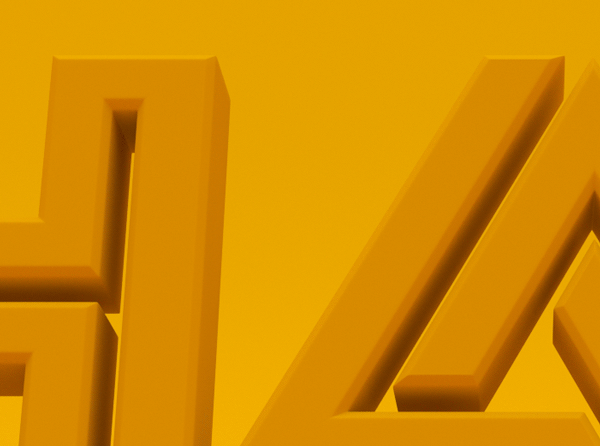

Hi Guys,
I think there is a tiny problem with the image antialiasing (the filter).
Even if I lower down the Filter Size value to 1.0. The renders seems to act like there is an effective blurring filter running.
Then I sharpened the image in PS to test. I posted gif anim of the region of the render. at %100. One frame for raw render, one frame for sharpened frame. Then a zoomed version of the area.
Please wait till the end. Gif suns at slow speed for you to compare. (*click on the image to play the Gif)
The render is done in Diffuse mode, ran for enough to reduce noise. Filter Size 1.0
What I would like to have is be able to create crystal clear renders without too much PS. I mostly render product viz. So it's Crucial for me to keep the clean sharp output.
Please do not give advice for workarounds sharperners. I would like to know if Dev Team is planning to deal with the problem possibly in v4?
happy new year

Hi Guys,
Sorry if I am asking a silly question in your case, but just don't want to assume anything...and I am sure developers will address you on it if it is a known issue. But just to troubleshoot:
(1) Do you have camera focus adjusted appropriately, and
(2) can you reproduce/load the scene in an earlier V2 and get the sharpness you want and expect? This is usually the interesting part ;)

We have always had to sharpen our images, even with 0 aperture and filter size set to 1.

Notiusweb wrote:
Re: OctaneRender™ Standalone 3.00 alpha 2
Postby oguzbir » Mon Jan 04, 2016 2:43 pm
Hi Guys,
Yes it'a silly question. Kidding you mate. :)
But yeah, Of course camera is focused correctly. With 0 aperture and all..
It is the same for all versions.
What I'm asking is:
Is there a possibility if Dev Team can make rendered images more crystal clear. or let us give more settings to make that happen
My Portfolio
windows 10 Pro. |1070 + 1070 + 1070 + 1070 | i7 @4.5Ghz
