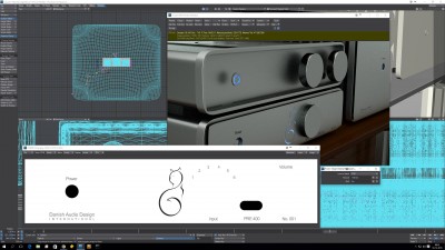

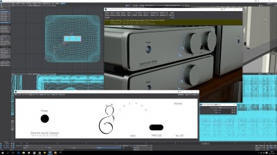

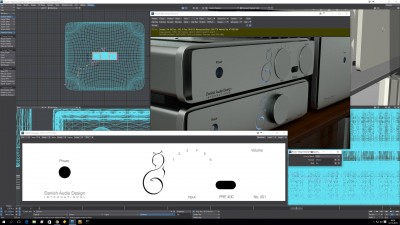

I did some more displacement tests with my models I've used it on and attached are IPR shots with displacement node settings and the displacement map itself. I felt it was better to have the different settings visualised as a result than just explaining it. Sorry if it seems excessive.
From what I've learned only the displacement amount will affect the displacement. The Shift value does absolutely nothing. When I set the displacement to 1 um it looks normal with no displacement. Any negative value pops it a specific amount back. Different negative values will not change it.
Large negative displacement and huge shift
Small negative displacement and huge shift
Larger displacement and huge shift
Original displacement and huge shift value
1 um displacement and no shift
Same settings but with no shift
Original displacement settings

The shift value is useless currently, it is deprecated. The next build will add the new mid-level parameter to control the displacement offset.
-Juanjo
