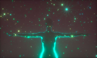

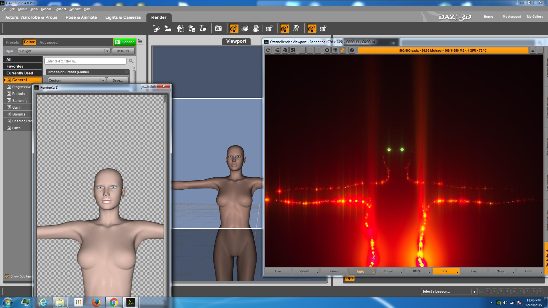

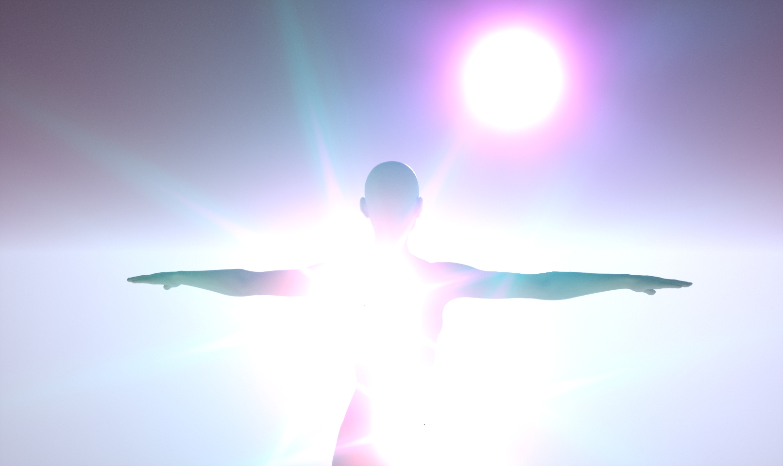

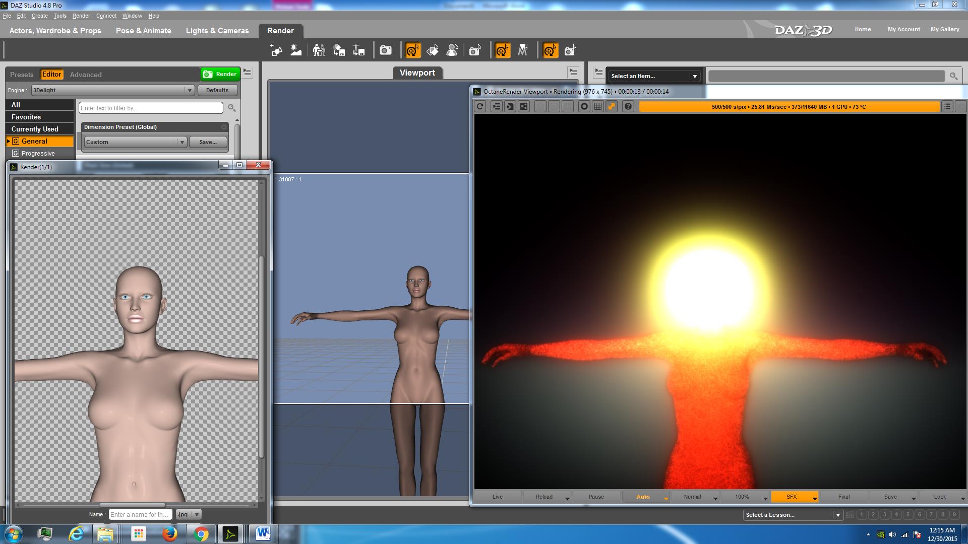

Paul, this is pretty wild stuff we're able to do with the Medium sliders!!! Love it.
My only hope is that the 3.0 engine itself gets better speed and UI performance as it undergoes development. The (1) render speed and (2) smoothness of pan, rotate, and zoom in the standalone UI with multiple GPU was better in V2, and the sliders offered to adjust performance to memory never get it to the V2 performance level...But granted this is a standalone engine thing, not an OcDS thing. (I haven't tried OcDS 3.0 with 12 GPU yet....)
The software may be outgrowing the hardware, just V2 did it so fast, so we're spoiled now.
Although, in V2 I couldn't do this! :
I am Goddess of the light... now how do I shut myself off...
I AM the Christmas Tree
