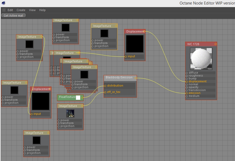

Using the node editor causes a weird behavior from time to time. See attached screenshot: sometimes one node like eg. FloatTex or ImageTexture is displayed infinite times.
It produces the same node whenever you drag it away.

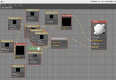

Ron wrote:Using the node editor causes a weird behavior from time to time. See attached screenshot: sometimes one node like eg. FloatTex or ImageTexture is displayed infinite times.
they should come from old scenes. There was a problem on embedded floattexture creations. Ex. floattexture in emissions. You can delete this leaked nodes. Any unconnected node is leaked.
OK - but deleting leaked nodes crashes C4D immediately.
EDIT: deleting any node crashes C4D in all materials :-((

Ron wrote:
EDIT: Ok! I have found the problem. That's again a mistake on my side. I'll publish RC3, i hope that can be last fix.
EDIT EDIT: Could it be possible to test this immediate version for nodegraph. It's looking good here
http://render.otoy.com/customerdownload ... C3-win.zip

I will try it!
Edit: Tryed 30 min. Here it is working now as it should!

Tested RC3 and its looking good.
Thanks for your fixing this so quick!
