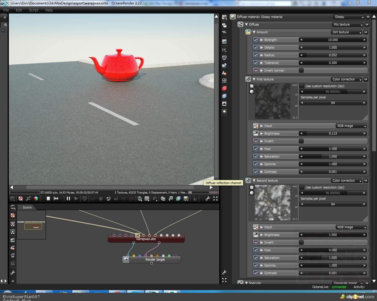

Elvissuperstar007 wrote:http://c2n.me/3eUWdvK.jpg dirt not work
Try increasing the radius or importing the scene at a smaller scale.
scene in millimeters, if I put meter starts artifacts, 2.21 in all normal
https://cloud.mail.ru/public/fc661aa0fa ... 20dirt.rar

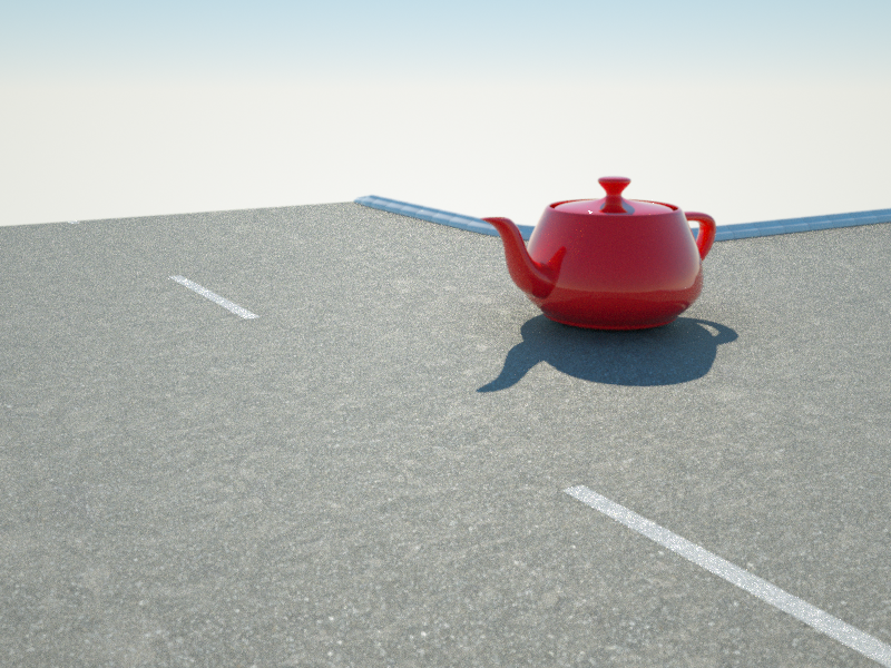

In 2.21.1 I get exactly the same result as in 2.22:
2.21.1:
2.22:

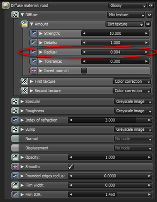

I'm not sure what you want to achieve, but as I said before, the dirt radius is too small. The teapot is about 2m in size and you have set the radius to 4mm:
If you set the radius to 1m, you see an effect on the road:
