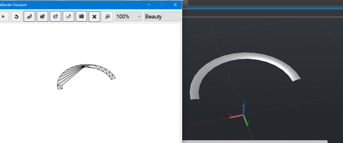

This shows the main issue - the curves vertices appear to be incorrectly ordered. The actual vertex positions are correct - but the triangle vertex indexes are not.
I have had a closer look at the geometry causing the problem inside the plugin debugger. The geometry being passed from AutoCAD is definitely invalid - the vertex indexes are just wrong :-/ It looks like for that specific geometry item (the washing machine door) the internal AutoCAD nurbs-to-geometry converter is broken.

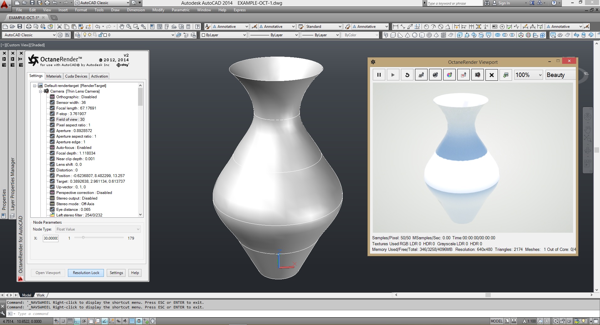

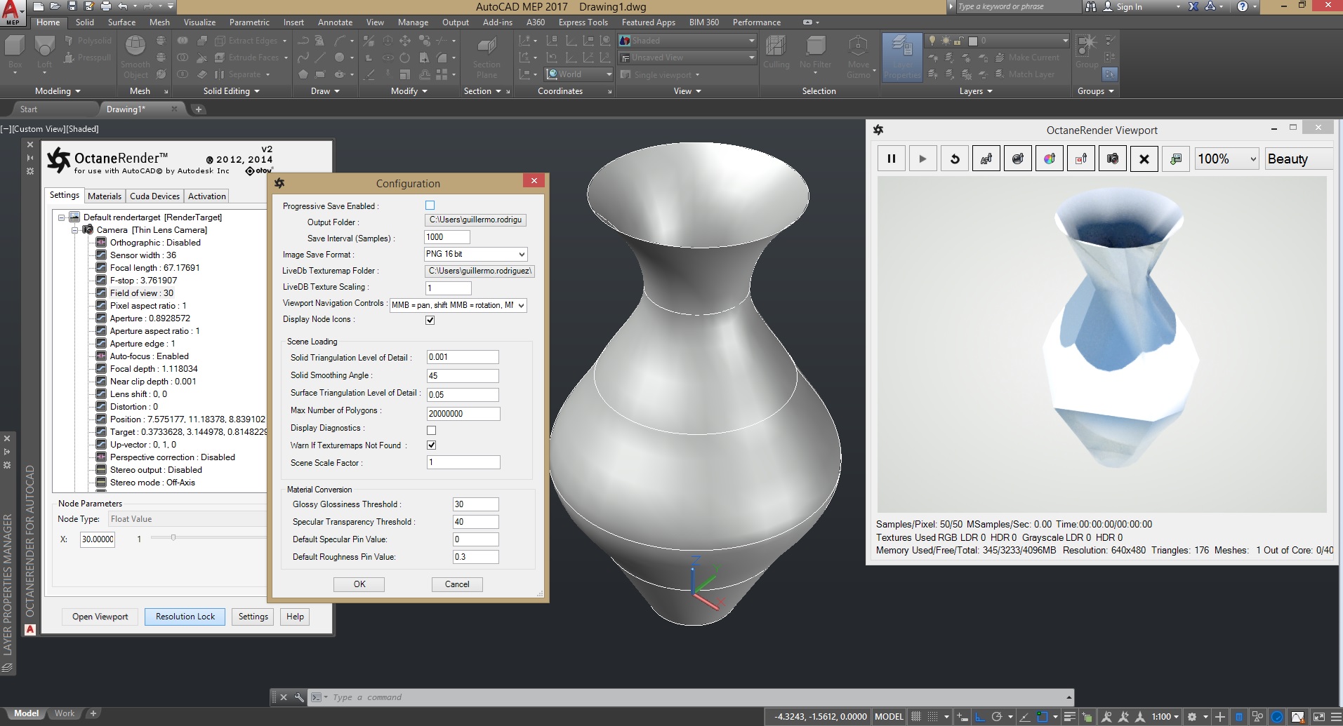

I posted 2 images with the same problem with a surface generated in Autocad, as you see Autocad 2014 render (load surface in plugin) is ok and for Autocad 2017 bad triangulation.
I think as you posted before that is Autocad (2015-2016-2017) api problem. Since Autocad 2015 they implemented Directx 11 acceleration... maybe it is corrupting something not sure anyway I tried without acceleration and same results with the plugin. Autocad 2014 is been rendering OK.
