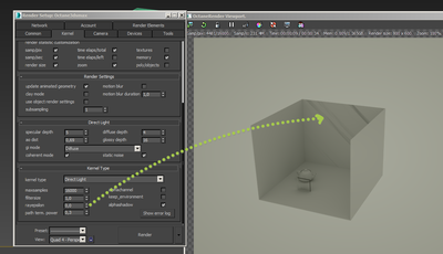

If I change the numeric value rayepsilon and then return to 0 I get the dirt on the materials

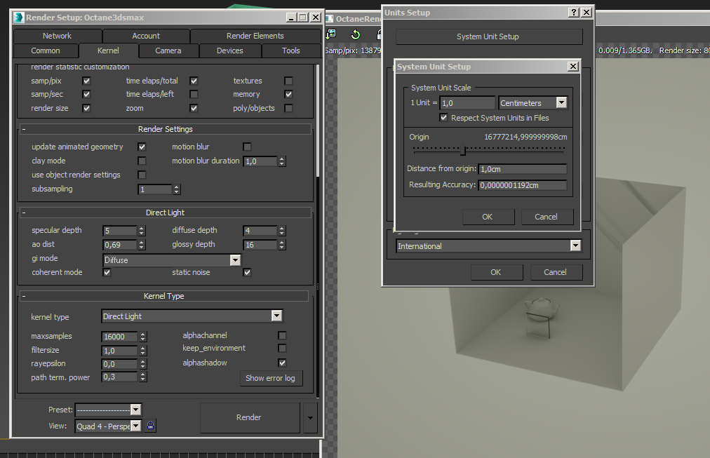

What is this
Do yu have an idea Karba ?

Goldisart wrote:If I change the numeric value rayepsilon and then return to 0 I get the dirt on the materials
Increase spinner precision in 3dsmax preference settings. default value is 0.0001. 3dsmax just can't show it properly because it has 3 digit only by default.
