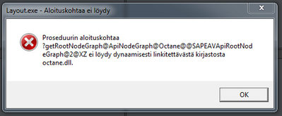

After installing the latest update I have this warning everytime I start Modeler or Layout. See attached.
(The startpoint of the procedure ????????????????????? can not be found from dynamicly linked library octane.dll)

Builtdown wrote:Hi,
Please, check that you have copied the last Octane.dll and Octane.dat available inside the beta2 .zip file in your LightWave/bin folder. This problem can be that you are mixing the new plugin .p file with the old Octane.dll and Octane.dat files.

Builtdown
Posts: 216
Joined: Thu Sep 04, 2014 2:21 pm
I have copied the latest dll and dat files, if you are referring to ones at the start of this thread.

Builtdown wrote:I have copied the latest dll and dat files, if you are referring to ones at the start of this thread.
Yes, you need to be sure that both the plugin .p file and the Octane.dll/.dat files are the last ones available in the .zip file. You can check the files dates to be sure, or search in your HD for the Octane.dll to be sure that you don't have an older one.
If anyway you can't enable the plugin, please let me know.

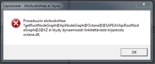

Builtdown wrote:Hi,
Haa, another FINNISH Octane and LW user (the error message revealed the secret) :)
