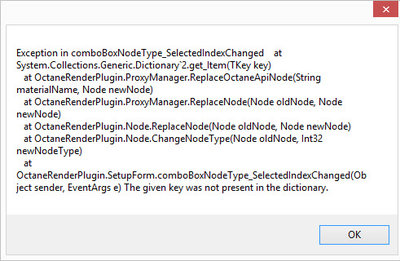

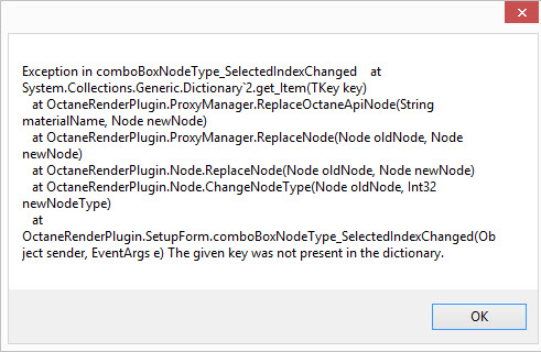

2. If I associate a Revit family with an OBJ model, set it to default and later remove just the reference of the selected Revit object, it does it, but then, if associate another OBJ model with that Revit object, it 'sees' the older model's materials in Octane's material picker... I know this because the materials names are incorrect and are associated with the older model. It's like a 'purge' of some kind is needed.
EDIT on #2: This is interesting. If another Revit family which is a proxy element is selected, the material picker seems to reference that model's materials. I deselected it and it then correctly identified the relevant OBJ proxy materials. But... life is never simple, and when I kept on trying to change materials on the imported OBJ, the plugin stoppped recognizing one of them (it just did not change the material in the plugin materials tab). Then, the error shown in the bottom image. Nothing crashed, it's just broken.

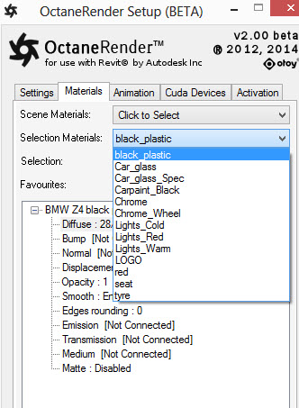

Notwithstanding the error I just reported, I would like to request that the material we pick actually gives accent to the ACTUAL material we picked, even if it is nested in a proxy model. So, if we use the colour picker on a proxy, the 'selection materials' gives this drop-down box with all the object's materials, which we then have to go search for. I would really appreciate if you could give accent to the relevant material that we don't need to go hunt for it, which is a but unintuitive.
Cheers,
Seeker
EDIT: Oo, my bad - looks like I'm on a roll here... So the 'selection materials' have always only been available if an object in Revit is selected, of course. So to rephrase the request... would it be at all possible to (in addition to having the drop down list) also have the colour picker give accent to the actual colour being picked in the render VP?
