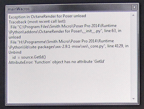

After updating to OctaneRender for Poser 2.11.1.31 (64 bit) I get this, when closing (Exit) PP2014:
(sorry for the lousy quality of the pic. I had to get it old school, with a digi cam, since I couldn't get the window to show up on a screen cap =) )
Fixed in the next release.

I have refreshed the installers at the top of this thread with:
2.11.1.32
- Fixed python exception displaying when exiting Poser
- When running HDR Light Studio, is the current Octane Environment does not have an RGB Image node attached to the "Texture" pin, one will automatically be created
