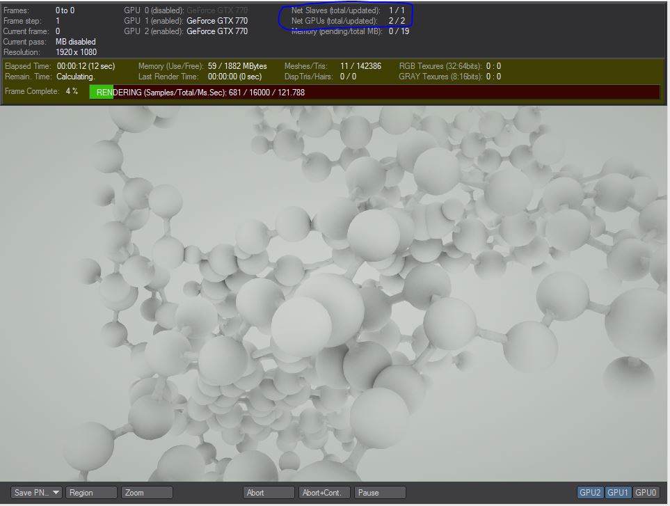

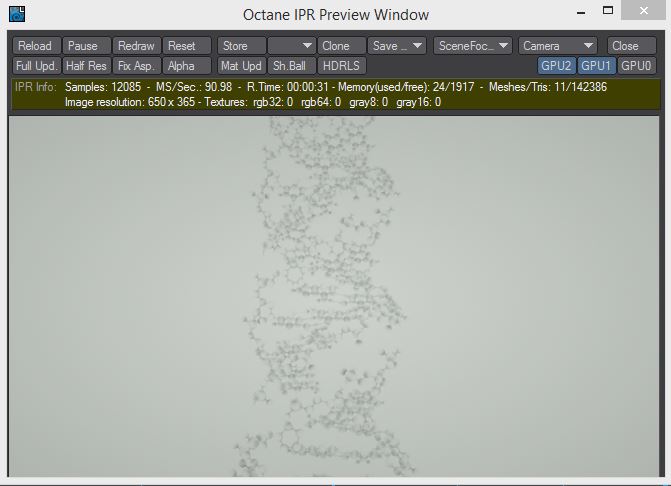

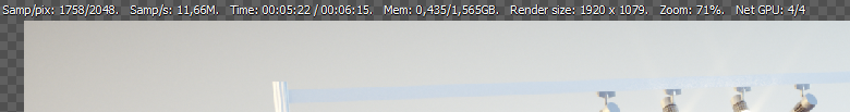

sigmamoon wrote:Hello Juanjo
Thanks for the upgrad, but i have a request
the octane 2.02 plugin for 3dsMax give us the "NET GPU" information when we use the "OctaneRender Network"
Could we have this information too in the IPR render windows.
thanks
Just to show you my request
look at the IPR informations over the network options activated
and see the Lightwave "octane preview IPR" informations versus "octane preview windows"
could we have net the same informations inside the IPR windows preview too (to know if our licences are really efficient when the network options are activated)
3dsMax IPR informations Windows render, NET gpu ON IPR NET gpu OFF IPR NET gpu ON
ONLY the Ms/Sec tell us the Net gpu is activated but we don t know how many nodes and how many GPU are activated (if i dont make mistakes)
