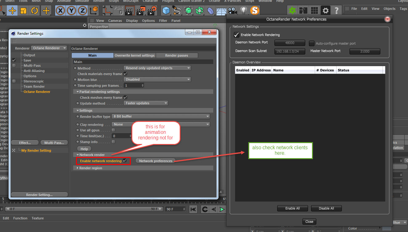

have you selected "network rendering" in render settings?futoryan wrote:Can you elaborate on this? I'm having an issue with Network Rendering working in Live Viewer but not Picture Viewer.rodross wrote:Ah, so you have to use completely different settings to use in the PV.

Can you be more specific about which setting you're referring to and where it's located so I can enable it?

I've enabled Network Rendering in the Octane for Cinema 4D's Live Viewer menu, as well as selected the slave and actived it. It seems to become disabled each time I try to render to the picture viewer, but appears to be working in the Live Viewer.

ok sorry. LV's menus will not affect render settings. Check this image. Nothing is complex here. If you can render in LV, this will work in animation render.futoryan wrote:Can you be more specific about which setting you're referring to and where it's located so I can enable it?

Thanks Ahmet,
I appreciate your help, this fixed the issue. Apologies for the tone of my last response. Technical problems bring the worst out in people.
