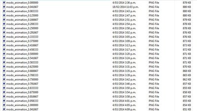

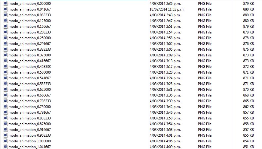

Hello everyone , some finds and reports.
1.Tried rendering some animation , fond the following issues with it.
1.1-the naming of the files is a bit nuts(see attached images) , guess ideal scenario for this is having a proper animation render dialog setup.like names , paths , timeframe etc.
1.2-there was other files on that folder(the folder you set on the prefs) and they were left there blending up with my new render sequence
edit-they all have odd numbering , so naturally they just blended.
1.3-animation keeps rendering for ever , even when it reaches the especified time limit.
1.4-no exr output , only PNG
1.5-Plugin re imports all the geometry every frame.even if nothing is changing
1.5-(suggestion) should have a way to add post effects(like glare and such) in a bach , so you could have both versions.
Cheers
Raf
