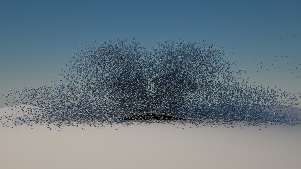

Why is this working for you?
My result is (in preview as like as in rendered):

Jim, dafassi, Spock :), Particle objects are not working with OctaneRender™ for Blender 1.27 - 3.1 beta Win if you change to scatter or movable proxy.
Dafassi, if you change back to Global it work but take about 10-15 seconds to transfer.

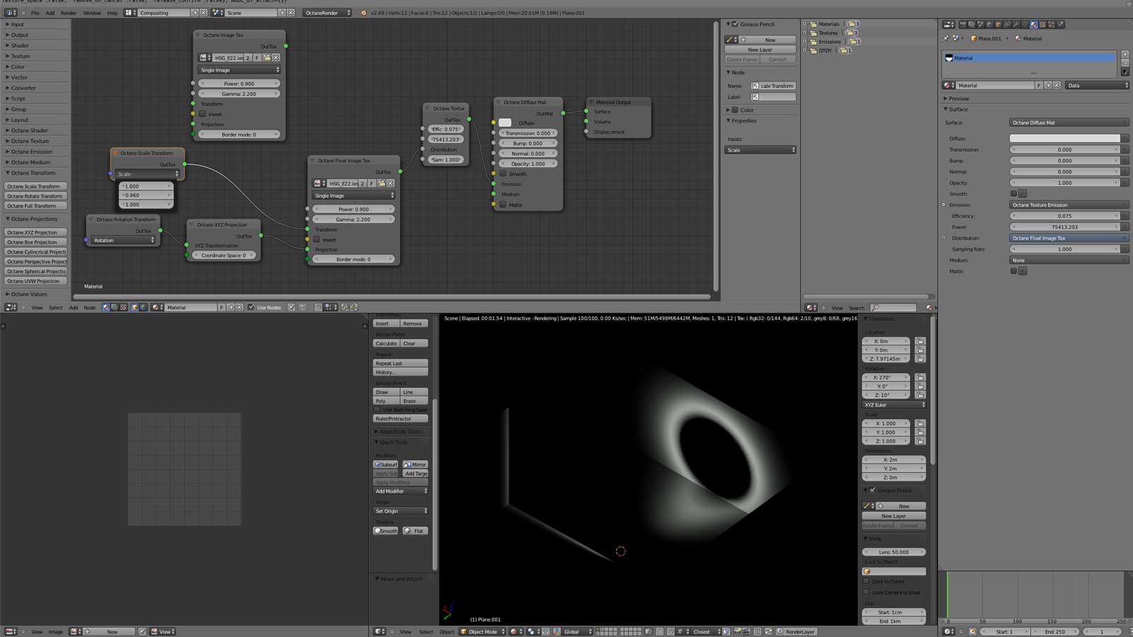

Any one out there using IES lights and figured out how to control them in the current release?
In the previous version the rotate and scale options were integrated in the float image and texture emission nodes. Now I assume you have to plug in the transform and projection nodes in order to get the same functionality.
The issues I encounter are that when scaling the light it behaves strangely (see image and the hole that appears in the center). Also, the ies light and the plane must be rotated with the exact amount, or you get a strange light leakage that did not appear in the previous version. In the attached image the plane is rotated 10 degrees in the z axis regarding to the ies lights rotation node, and you can see the result of the light leakage on the walls.
Have I connected the nodes the wrong way, or is it simply not working yet?
I have tried to find information about the new projection nodes in the forums and on the rest of the web with no luck. I would really appreciate if any one could point me in the right direction , if there are any...
EDIT:
So, I finally found this: http://render.otoy.com/forum/viewtopic.php?f=51&t=38161. The transform node that should be used for IES-lights is the spherical one. This takes care of the bleeding that I experienced. I still have not found a solution for the scaling of the light.

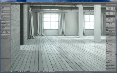

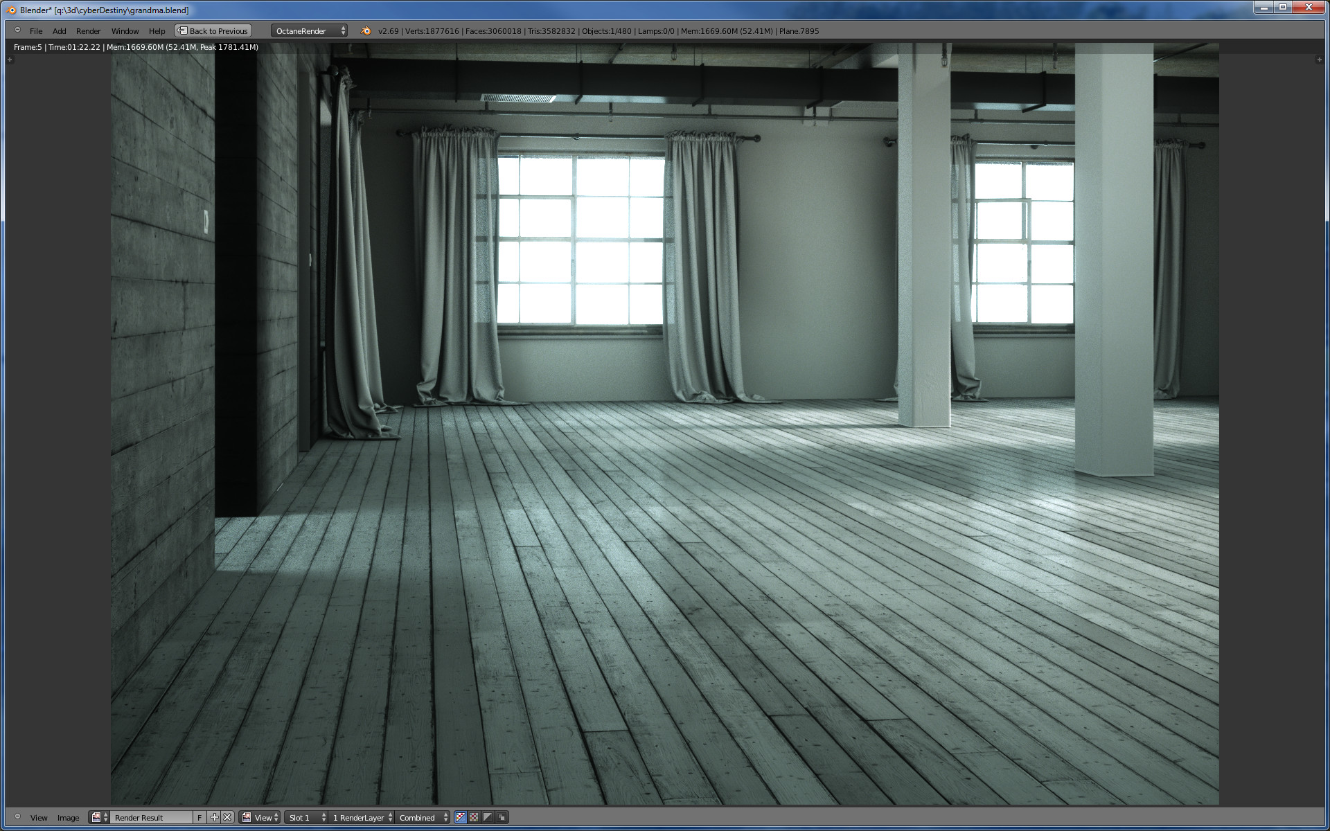

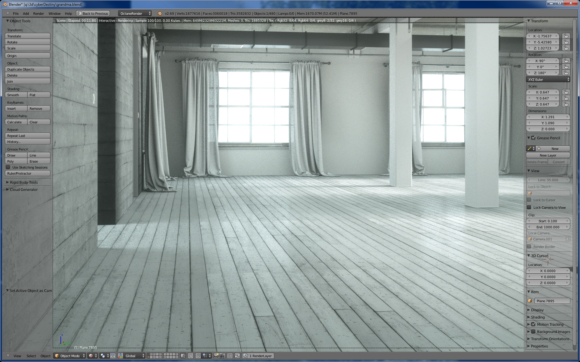

Shouldn't the result in the viewport when I'm in camera view be quite the same as the result when rendering ? I get much darker results, see below :
Edit : I think I found the problem, the gamma value set for the camera is used the same way in the viewport session and during rendering, when gamma is set to 1, in the viewport it seems to use the value 2.2, if I change it to 2.2 in the camera settings, the render gives the same result as the viewport.
Viewport
Render
