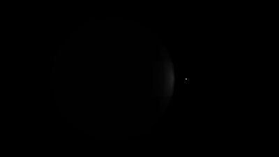

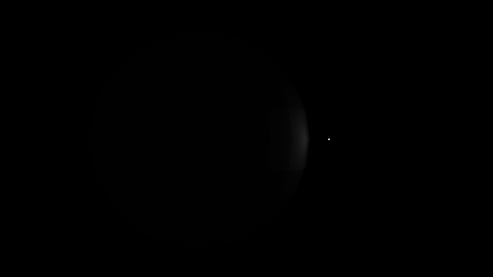

There is something fishy with emission. Those two spheres have the same emission parameters. Yet the small one is much brighter then the big one. If I scale the small one in Layout it keeps it's brightnes. I had this problem with HDRI images if you remember. It wasn't like this before. Could you take a look at it and report a bug if it is one ? Thanks

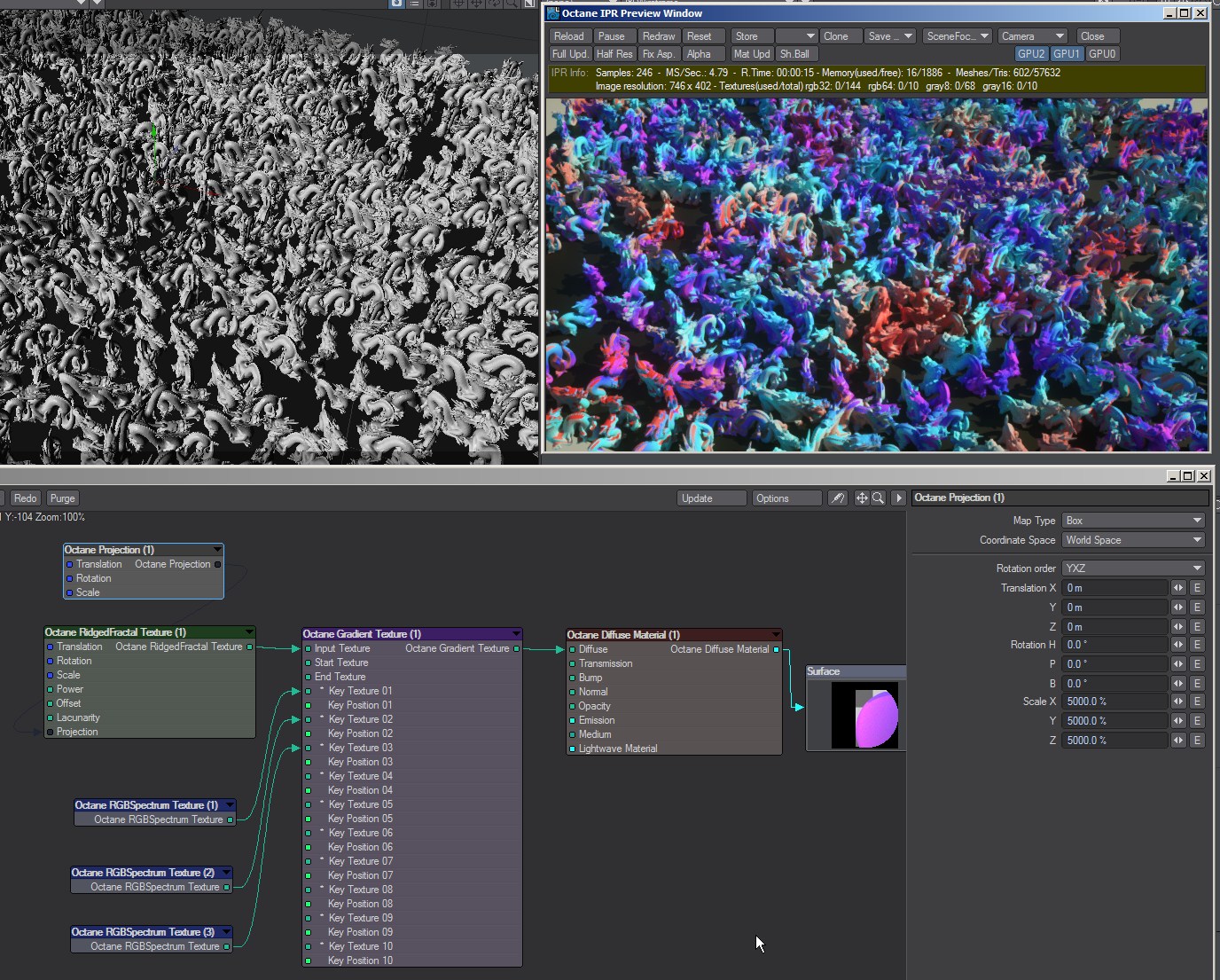

Is it possible in LW to color instances like in this post:

BorisGoreta wrote:Is it possible in LW to color instances like in this post:
http://render.otoy.com/forum/viewtopic. ... 96#p170510
Not currently. Lightwave plugin uses other kind of node graph to render the instances using the Scatter node. Only one scatter node can hold thousands of instances inside it, using very little memory because we are using only one node. The node graph you show in this post is really complex to be used in scenes with thousands or even hundreds of thousands of instances, and anyway Lightwave plugin doesn't use this kind of graph while building scene.
I think that this feature should be implemented at shading level, for example now you can use a world space texture to apply random colors to instances. An ideal solution could be a node that returns the instance ID to drive a material mixer or a gradient node, but it not available yet.
