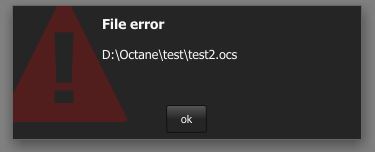

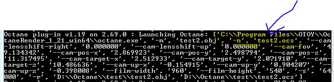

Hmm, looks like the -n option is not working. Either that or I have done something wrong.
Here is the command line used
but Octane complains
Can you spot anything?
No test2.ocs was created by the way.
