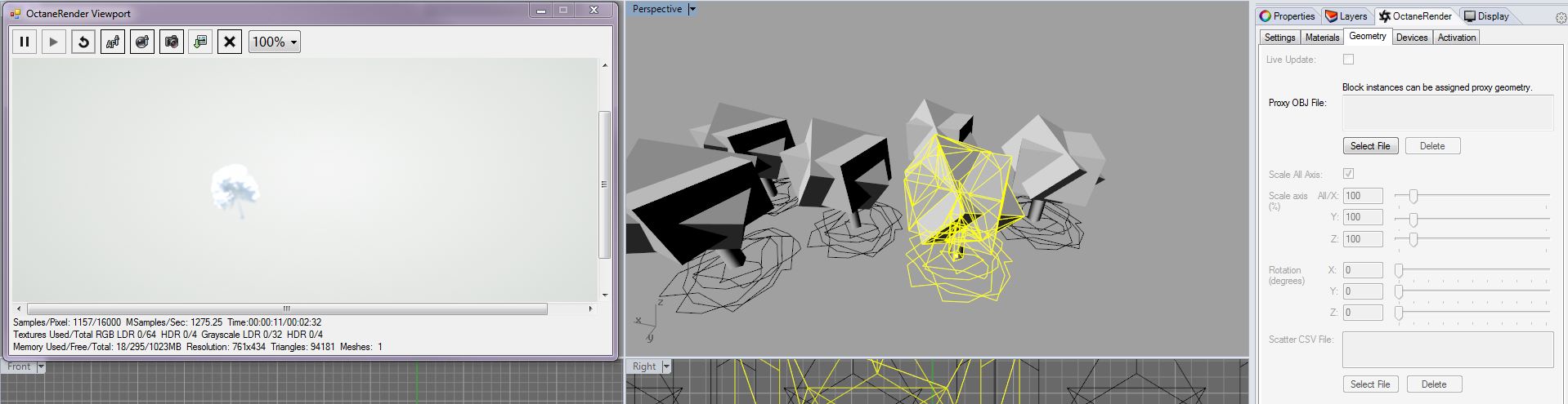

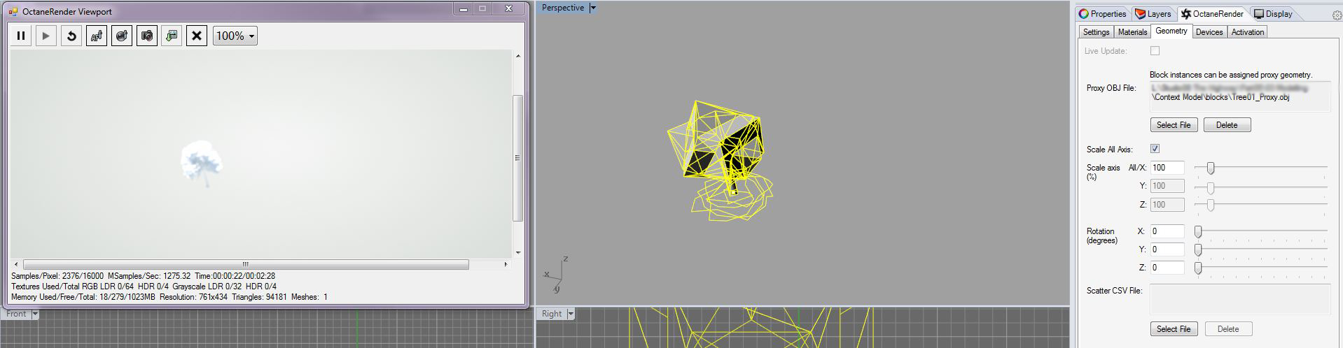

face_off wrote: For your 1000 tree blocks - how did they get there? If you copy/pasted a block instance, then simply copy/paste the block instance after you assign the tree proxy OBJ to it. If you are generating 1000 block instances automatically (can that process replicate the already assigned proxy block instance?
Paul
Hi Paul,
There seems to be an issue with retaining the proxy properties when copying in instance. See attached images. In this case, I had one block with a proxy assigned which seems to work fine, and then copied it, and the copied blocks don't seem to have a proxy assigned, and (after viewport refresh) do not show up in the viewport. It seems that it doesn't work for nested blocks, either, as it clears the proxy file when nesting.
It would also be nice if the CSV file was also interchangeable with a .txt (since it's much easier to generate) - as this is what happens in Octane Standalone.
It would also be very useful to have a 'apply proxy obj file to selection' rather than necessarily doing it one by one (for things like fauna, and anything on mass really).
Newske
One block proxy works fine
Copies of the block don't seem to work
Octane for Rhino | Windows 8.1 x64 | i7-3820 OC | GTX970 4GB OC & GTX 560 Ti 1GB OC | 32GB DDR3
face_off
Posts: 15811
Location: Adelaide, Australia
I have reported a bug to McNeel where Rhino is not copying the instances attached info (ie. proxy data) when you use the Rhino "copy" command, but it is working if you do a copy/paste. I have not heard back yet from them on this.
