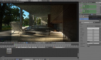

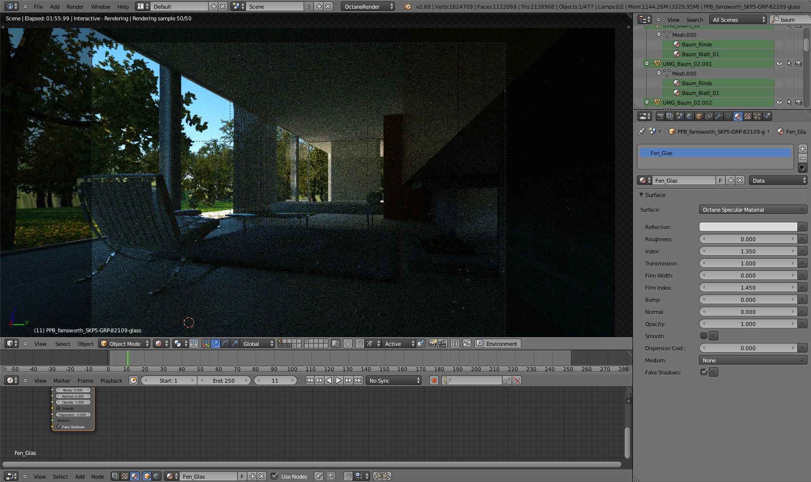

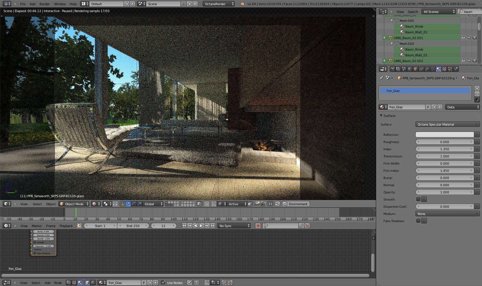

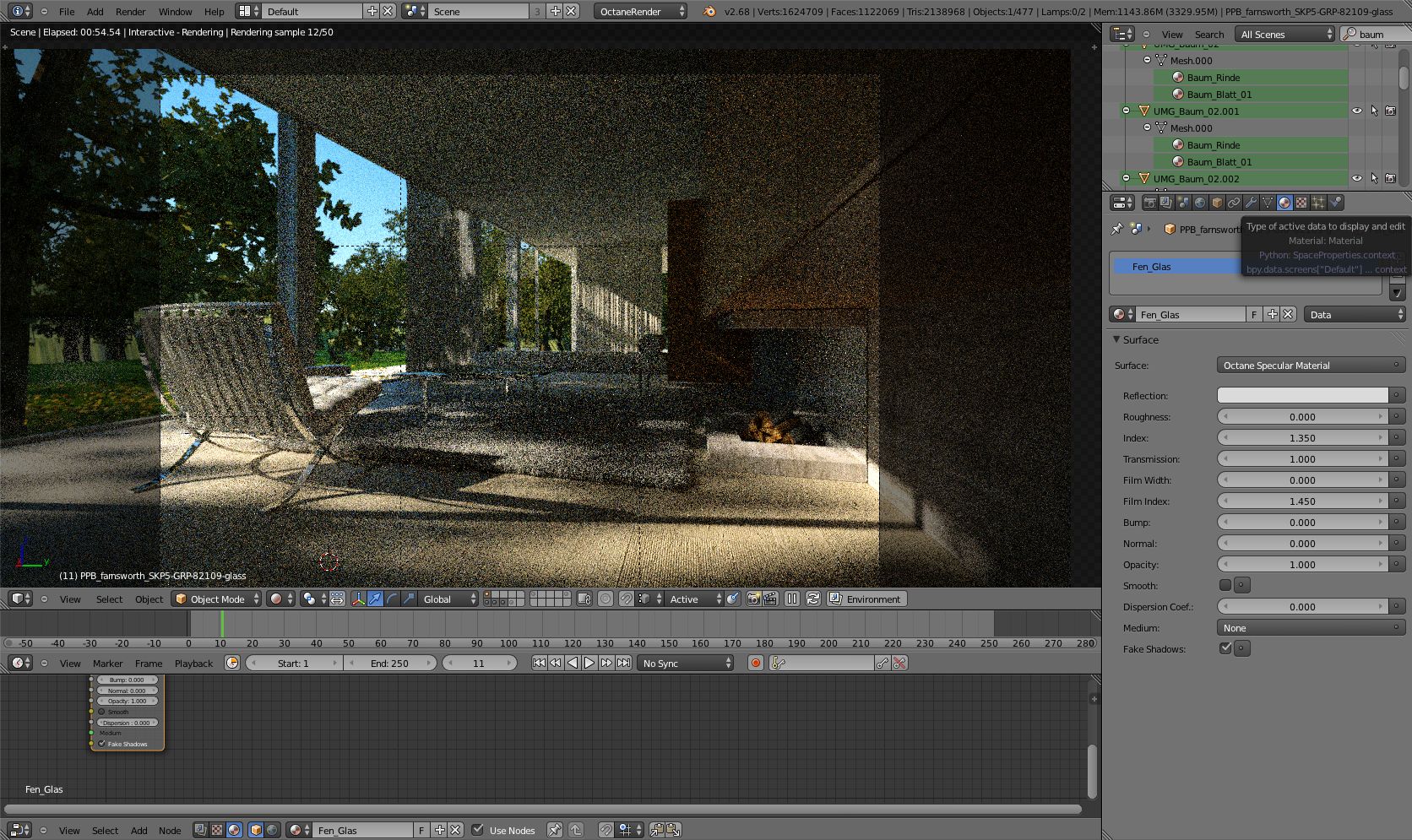

Another Bug:
When I use a "Octane Specular Node" for the windows glass (Materialname "Fen_Glas") and turning on "Fake Shadows" it happens sometimes that Fake Shadows do not render correct, they render like "Fake Shadows" is turned off.
See here (Fake Shadows turned on in Material Node):
Then I have to turn off "Fake Shadows" and it renders correct.
See here (Fake Shadows turned off in the Material Node):
When I turn on "Fake Shadows" again then it still renders correct, see here:
Edit:
Sometimes this happens when I change Values of other Material, for example when I change the Roughness Value of the Floor material.

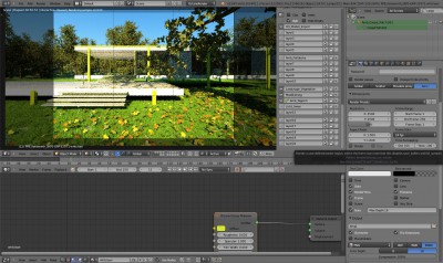

The following seems to be a Bug too.

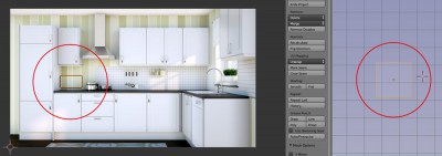

In some cases "Render Region" does render only a part of the selected region, see here:
Did not find out yet when this happens.

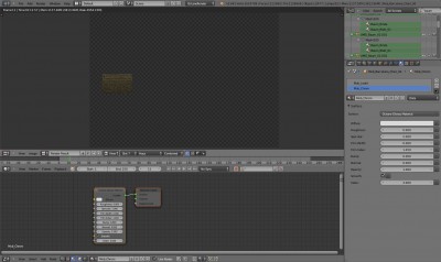

Edit:
And when I render with F12 then it renders something completely wrong, see comparison here:
Kind regards
Alain
Intel Pentium 2.8 GHz 2 Cores, 8 GB RAM, GeForce GTX Titan 8GB, Blender 2.72b, Win 7 64 Bit

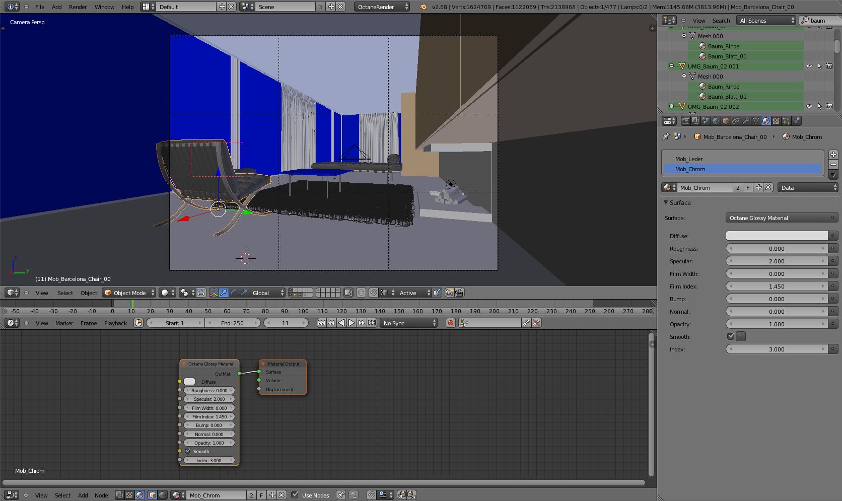

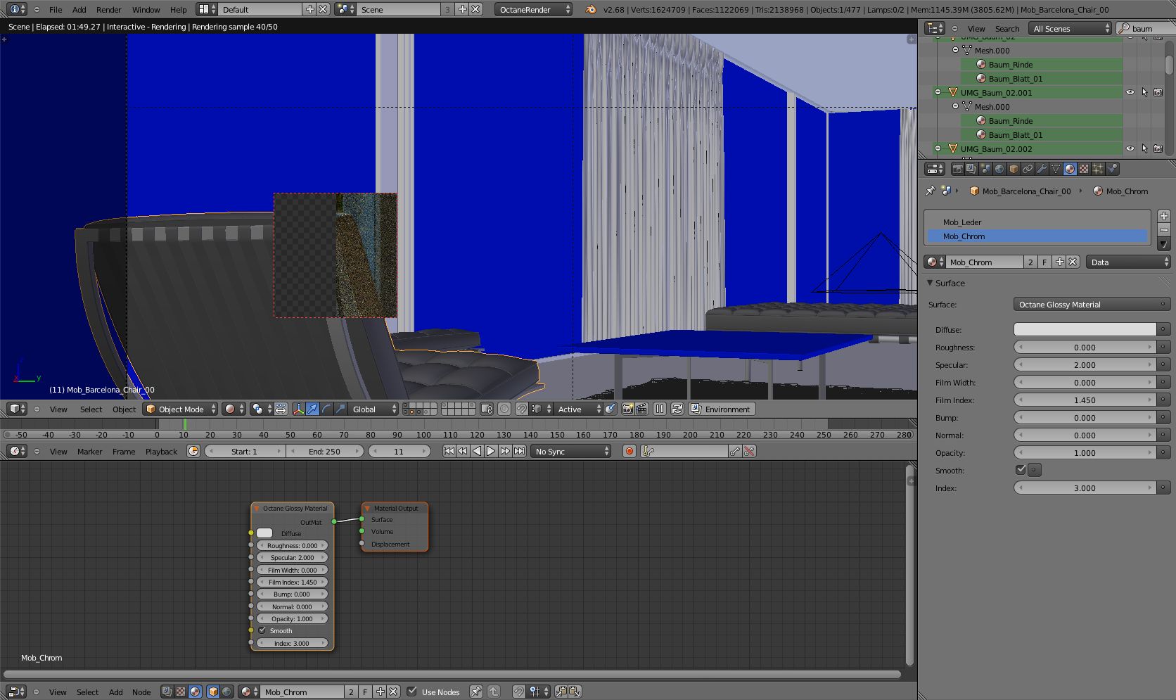

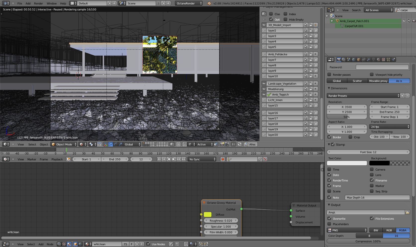

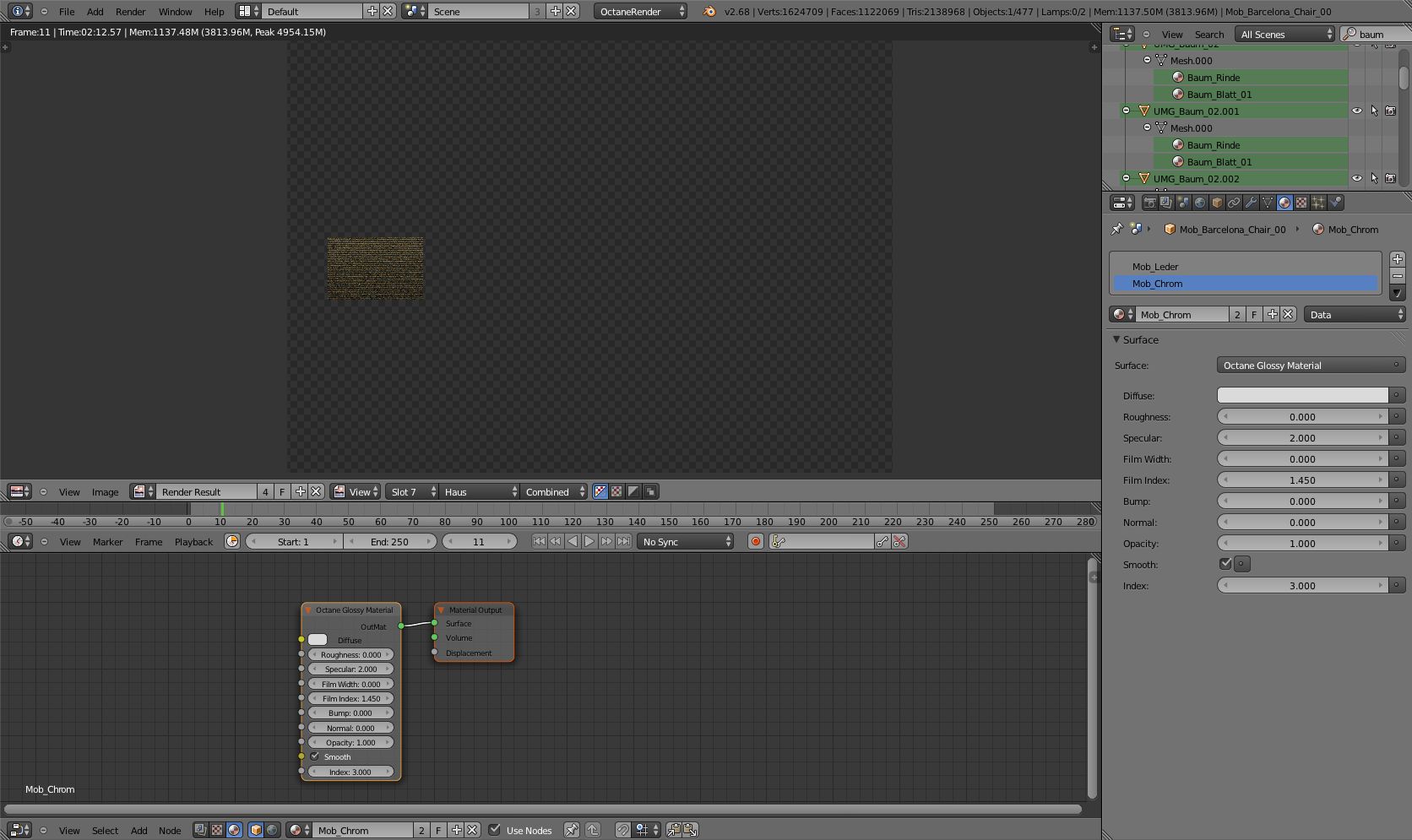

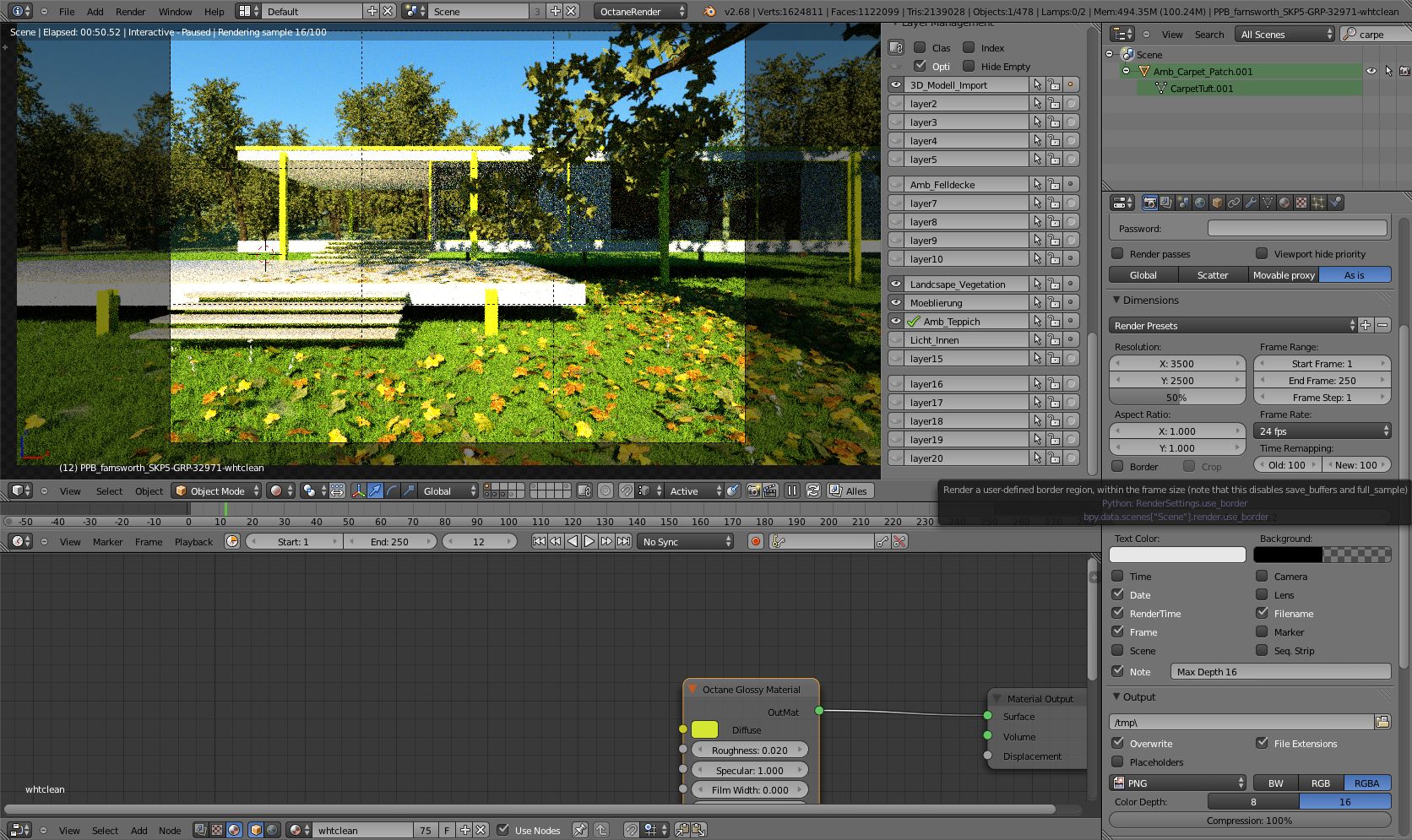

Render Region seems to be just a fake !
Render Region:
Then hitting the Pause Button.
Then unchecking "Render Region".
Then you see this:

Alain wrote:Render Region seems to be just a fake !
What? Who have told you at all that the "region render" feature is available in the plugin, to let you name it "the fake"? It is just "setting the borders" feature which I've coded in the integration for your convenience despite the fact the Octane engine does not support regions at all.
Have you read the announce thread?
http://render.otoy.com/forum/viewtopic. ... 99#p149299
I can disable borders support, if you don't like it - all for your pleasure.

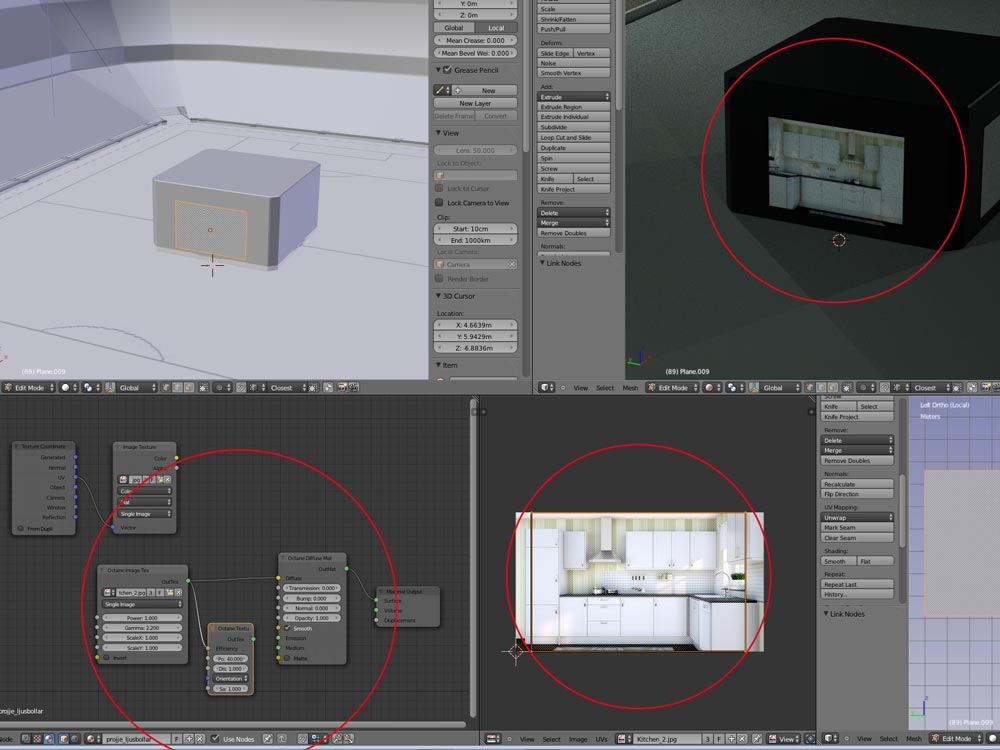

mib2berlin wrote:Hi Marten74, I am not sure I understand all what you ask.
This is a plane unwrapped from view, right is 3dview shading (Material), left is render.
Cheers, mib.

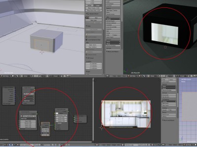

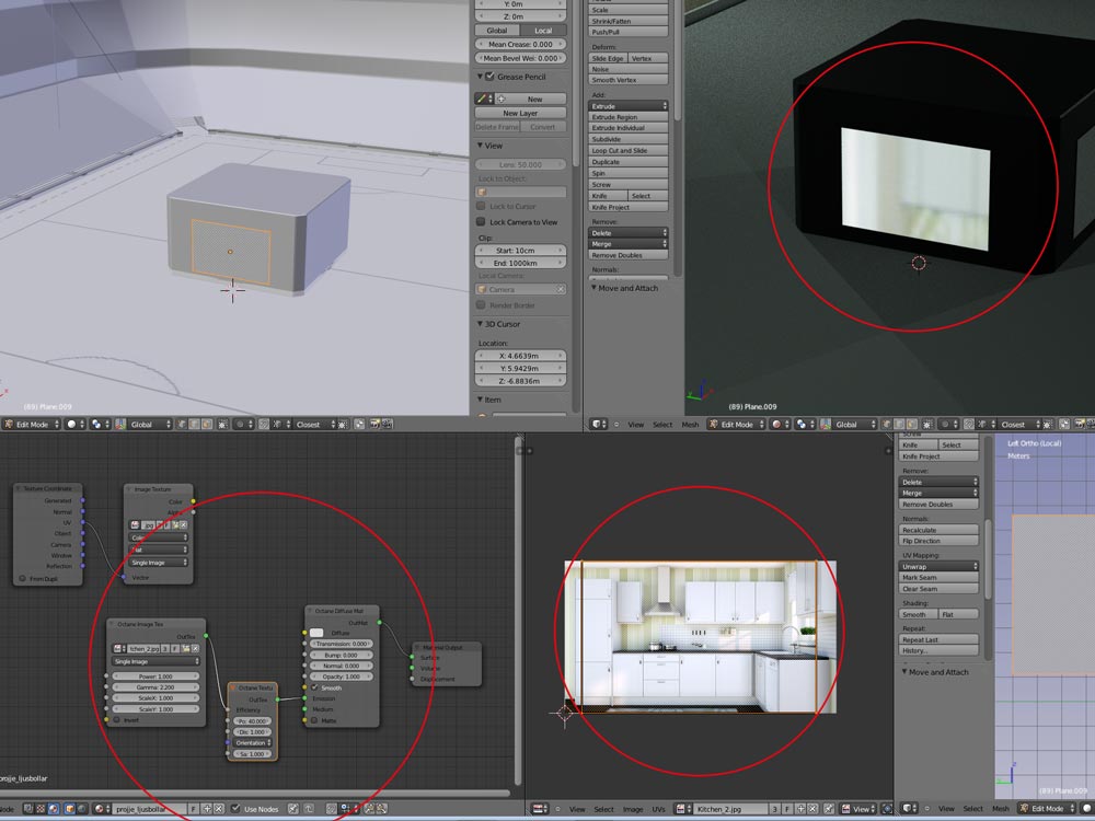

Hello, and thank you for your answer!
Some images in this post to explain my issues a bit better.
Here you can see my problem with projecting a square that adopts the resolution of the image. I I hit ctrl + P it´s a perfect match. Not sure if it has to do with an image beeing "pre loaded" in to the texture slot, but I never had this behaviour working in the regular Blender. For some reason for the other two examples/images I got the uv-mapping working the way it should. I did not by accident use "project from view (bounds)" that would have given a similar result. The surface would have covered the whole image then though. Not sure what it is that gives the first strange projection result...
In the other two images you can see that for the texture emission the UV mapping is not working correctly. As you also can see I have tried to figure out a way using nodes to get this right. The problem is that I don´t have time to sit a bunch of hours to figure this out, so I´m hoping some one with more experience can see if I´m simply doing it wrong, or if there is a little glitch some where in the plugin.
You can also see that I don´t see the texture in regular shading mode. I have also tried to apply the texture in the texture panel, even if this should not be nessesary. This problem made me realise that the shading options in the display menue in the properties panel are missing. For you this seems to work the way it should.
I have a computer with a GTX Titan. I wonder if it can have something to do with that since the BlenderOctane is not the latest Blender release and I know that support for the Titan has been added pretty late, maybe after the first 2.68 release.
Thanks again for your post, looking forward to the next answer :)
Regular texture UV mapping ok
UV mapping not right for texture emission
Strange projection
Strange projection

Hi, could you post the blend with packed textures?
Are you able to get it in Octane standalone?
Post here: http://www.pasteall.org/blend/
Cheers, mib.
