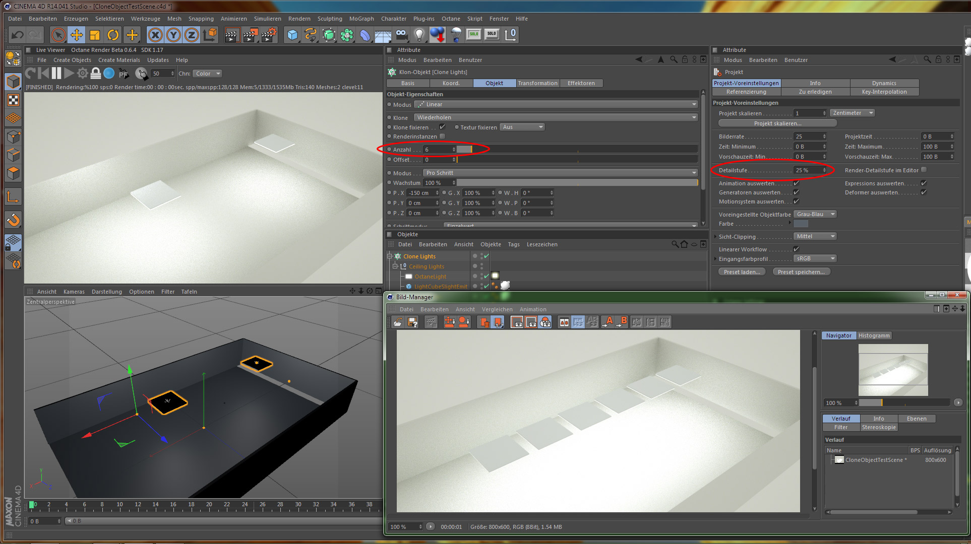

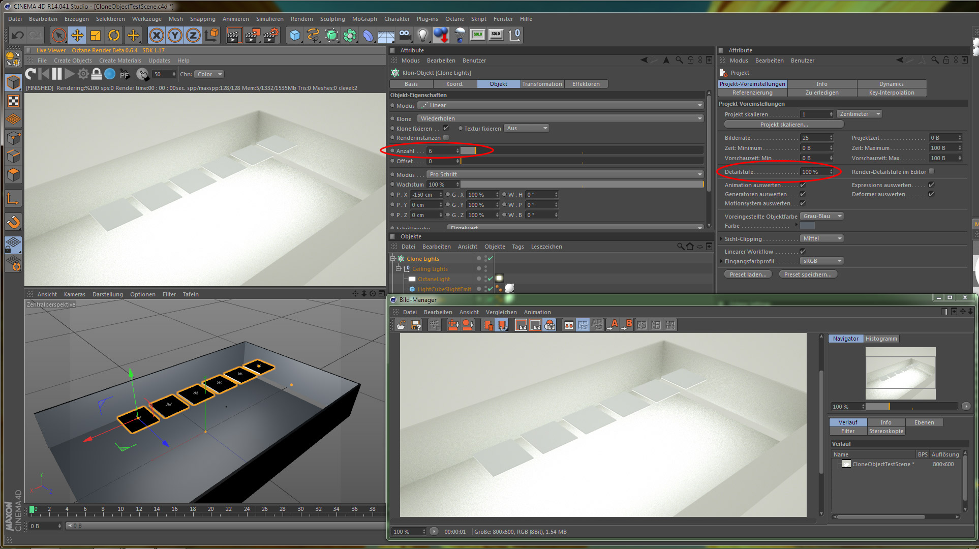

About the clone object or instances issue: I tried to recreate it with a new scene, but could not get the same strange results that I have with the project I am working on. So I compared the project settings and found the problem that I wasn`t aware of.
It has to do with the detail level settings of the projects... somehow it was set to 25% instead of 100%, so the open GL preview and the Octane Live preview didn`t show up all instances, but the picture manager renderer always does.
See the pictures above, I did a small test scene with some lights that shows the issue. So it is not a bug but something that might be helpful for anybody else to be aware of when working with instances.
